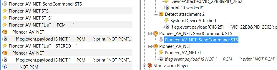

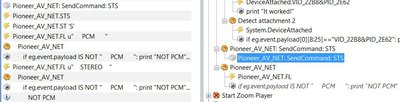

Postby kkl » Tue Dec 31, 2013 9:07 pm
Example using this plug-in (as suggested by sem;colon):
The event Pioneer_AV_NET.FL also includes info other than audio status, so other conditions might need to be set if that is the trigger.

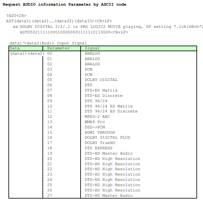

The only way I can think of to be able to tell if a movie is playing is to look at the “audio input signal”
In general this will be either AC3, DTS, DTS-MA or TrueHD. This is in the output from the ?AST command "data1&data2". If no movie is playing the audio input signal will be just PCM.
Request AUDIO information Parameter by ASCII code
?AST<CR>
AST(data1)(data2)……(data32)(data33)<CR+LF>
ex)DOLBY DIGITAL 3/2/.1 in PRO LOGIC2 MOVIE playing, SP setting 7.1ch(SBch*2),
AST050211111000100000001111110110000<CR+LF>
data1~data2:Audio Input Signal
With the Pioneer_AV_NET plugin either on port 23 or 8102, when I send the STS command I only receive: “Pioneer_AV_NET.STS” (while logging everything). With the other plugin I can send the command “PioneerEthernet.Audio.State” and receive the “PioneerEthernet.Received.AST.Signal 'PCM'”
DarkCinema

Postby kkl » Fri Jan 03, 2014 6:21 pm
I can only say that it all works for me. Make sure to send STS and not ?STS. Here's a screen cap:
Sending STS triggers multiple events, including Pioneer_AV_NET.FL u" PCM " if that is the current status. But if you're trapping for " PCM " as I demonstrated in a post above, you shouldn't need to manually try to trigger it. If you're never seeing Pioneer_AV_NET.FL u" PCM ", that's a completely different problem.
