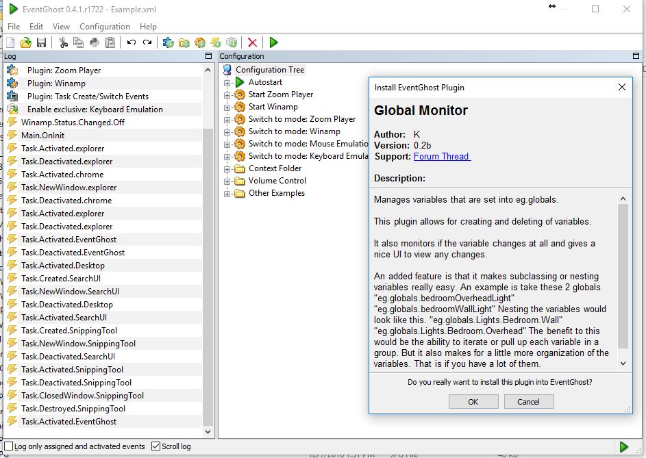

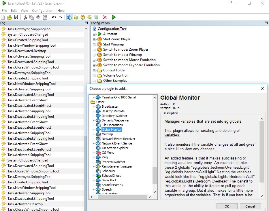

When I get back to my PC I will upload the plugin again. Maybe I sent up the wrong version. I did a code check against my source and the egplugin file and the code is the same. But I could also swear I changed the version number. And neither my source or the egplugin have the updated version.
You can do that as well. Go to your C:/program data/EventGhost/plugins/globalmonitor folder and open __init__.py with notepad. And at the top you will see eg.RegisterPlugin just below that you will see version=
If it is anything other then 0.1b something got mixed up on my end and I posted a wrong version

The version number in __init__.py is 0.1b. When opening GlobalMonitor,egplugin, version 0.2b is listed in the confirmation window. When adding the plug-in in the EG gui, 0.1b is shown. Please let me know if you still need those other files sent. Thanks.

i'm not concerned about the version thing. i changed it in the egplugin file but not in the actual __init__ that will not affect anything...
