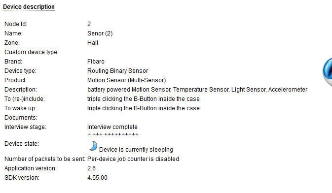

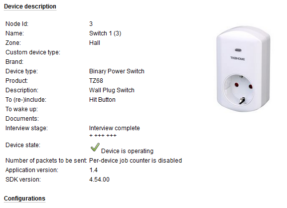

For the devices I have, im not sure what details you need, these are the screenshots off the top (I have no idea why it wont let me correct my typo from senor so sensor!)

The bit thats new to me with zwave is the device and instances.
I have a multi sensor which I think is device 2, and instance 0 and a switch which i think is device 3 and instance 0, does that sound right?

I presume then if I turn the switch on and off from the web interface I can see it reflected on EG (so long as i opened TCP port 1883 on the firewall)
Re: RaZberry: a full featured Z-Wave Home Controller
Post by krambriw » Tue Oct 21, 2014 2:05 pm
Yes, I think you are on the right track
First of all, what is important is that you have the file .syscommands (the name must start with a dot) and that the content is the word 'python'
For your devices, I think it looks ok but for me to check, you need to use the urls described earlier so that I can see if we need to modify/add some of the functions in main.js
If you use the gui, go to 'Device Control' and check the instances (they are inside parenthesis like (#1))

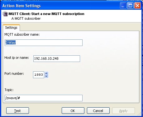

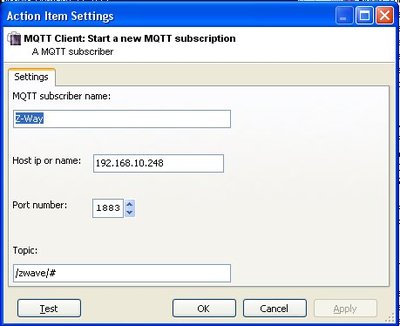

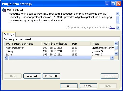

Please double check that you have configured the MQTT Client correctly and that it is listed in the plugin similar to below

Thanks, for some reason the MQTT on eventghost cant talk with the Pi, whether its a mosquitto issue or with the config im not sure.
15:25:04   Exception in thread Z-Way:
15:25:04   Traceback (most recent call last):
15:25:04     File "threading.pyc", line 532, in __bootstrap_inner
15:25:04     File "C:\Program Files (x86)\EventGhost\plugins\MQTT Client\__init__.py", line 144, in run
15:25:04       mqttc.connect(self.host, self.port, 60, "")
15:25:04     File "C:\Program Files (x86)\EventGhost\plugins\MQTT Client\mosquitto.py", line 569, in connect
15:25:04       return self.reconnect()
15:25:04     File "C:\Program Files (x86)\EventGhost\plugins\MQTT Client\mosquitto.py", line 645, in reconnect
15:25:04       self._sock = socket.create_connection((self._host, self._port))
15:25:04     File "socket.pyc", line 514, in create_connection
15:25:04   error: [Errno 10060] A connection attempt failed because the connected party did not properly respond after a period of time, or established connection failed because connected host has failed to respond
15:25:04
Post by krambriw » Tue Oct 21, 2014 3:26 pm
What happens if you use this command in Putty (in the Pi)?
sudo /etc/init.d/mosquitto restart
