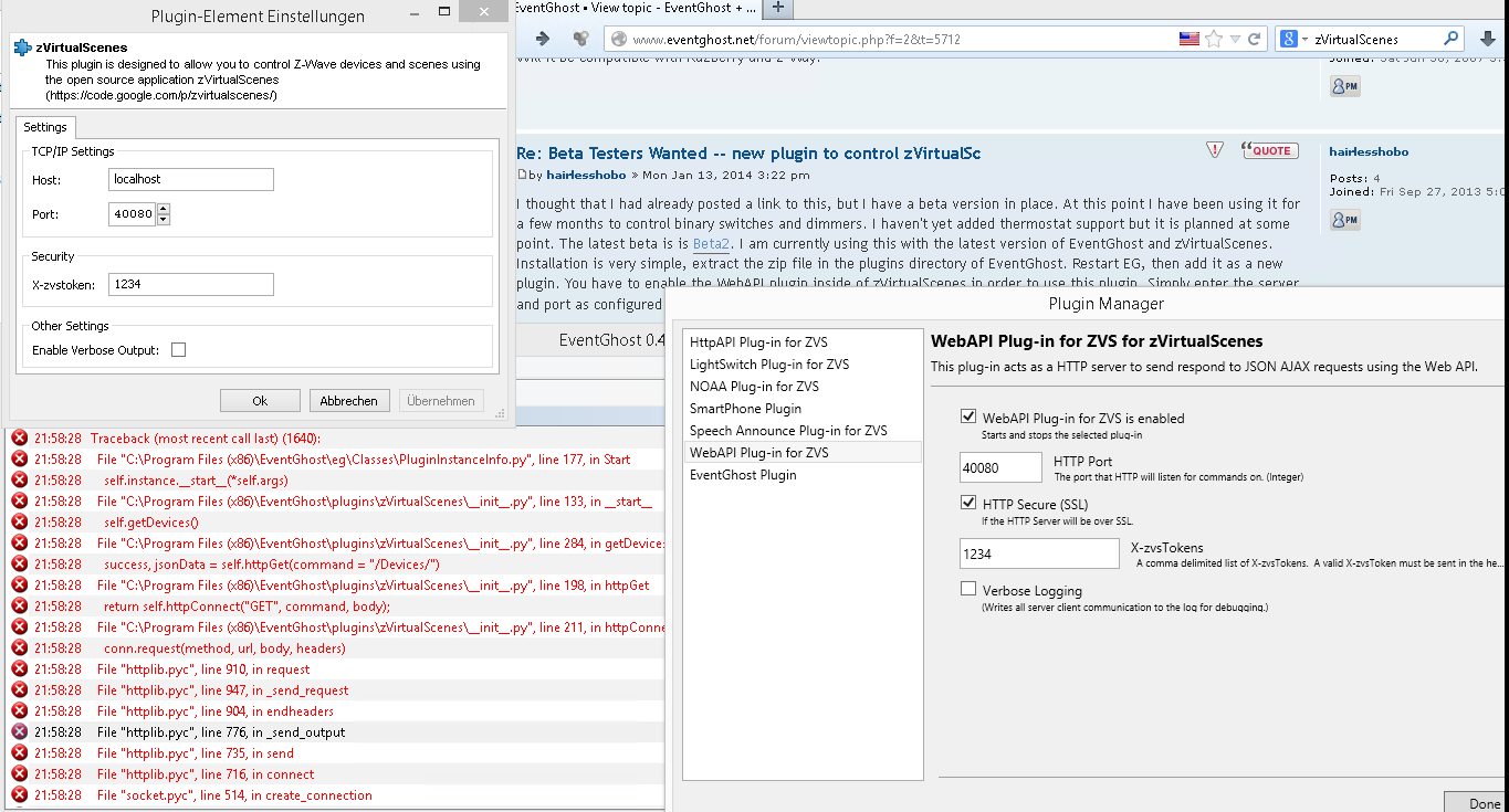

Hello hairlesshobo,
I have some trouble getting this plugin to work - is there something wrong with my configuration?
I also tried it without SSL and I deactivated the windows firewall.
EDIT: It seems like I needed to open zVirtualscenes as Admin - now I have a connection
