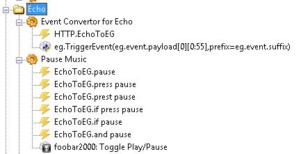

Someone PMed me asking for an example of how I use this plugin, so here it is:
I haven't figured out the 'intent' bit of the skill, so it's not expecting 'pause', in this example...a bit dodgy; thus the permutations, or mishearings of 'pause', and 'press pause'.

The example intent file should leave Alexa wild over to accept just about anything said.
I think you can also use a wildcard event. EventToEG.*pause*
Or a python script to search the payload for pause and fire a trigger if true.
cmd = eg.event.payload[0]
if 'pause' in cmd:
	eg.TriggerEvent('PauseMe');
	print 'Command is unknown: ' + cmd'
