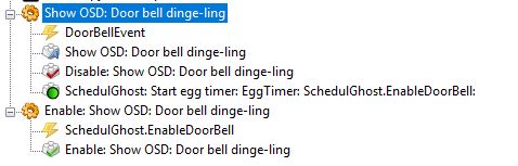

Ok, so I use eventGhost for my home automation and it works brilliant, however when the doorbell is pushed I get three to four entries in the log, wich casues as many pushbullets and ringings on my doorbell speaker.
How can I make eventGhost to ignore the trigger for say five seconds after it has recieved the first instance?

Post by krambriw » Mon Nov 14, 2016 5:04 pm
1) If you have a transceiver type RFXtrx or a TellStickDuo, the plugins supporting those both have settings that can help to avoid duplicated events
2) If not, you can make a configuration with other available stuff that can help. I will make a sample shortly

Post by krambriw » Mon Nov 14, 2016 5:10 pm
So this is a sample that should do

Post by kamsvag » Sat Nov 26, 2016 3:18 pm
Thanks, it worked just as I liked it to.
