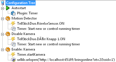

Postby pearbear » Fri Jan 06, 2017 5:17 am
OK, the attached file should do it.

Postby Lilak » Mon Jan 16, 2017 6:43 pm
Thank you very much for your help. Now it works perfectly!
