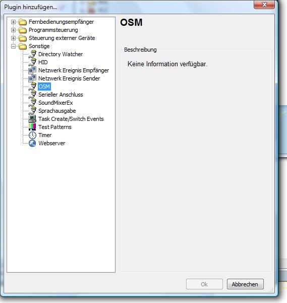

Postby tonixic » Mon Dec 29, 2008 7:16 pm
hi,
i have a problem. I can't start the plugin. I have copy the "__init__.py" in "plugin/OSM/". and I can see the OSM plugin in eventghost. But i can't start (see the screenshot)
what should i do ??
thx cu

Postby Pako » Tue Dec 30, 2008 7:17 am
What version of EventGhost you use?
Try the latest *_Setup.exe from here:
http://www.eventghost.org/downloads/
Posts: 1283
Re: OSM (On Screen Menu)
Postby tonixic » Tue Dec 30, 2008 10:52 am
thx it works !!! =)
