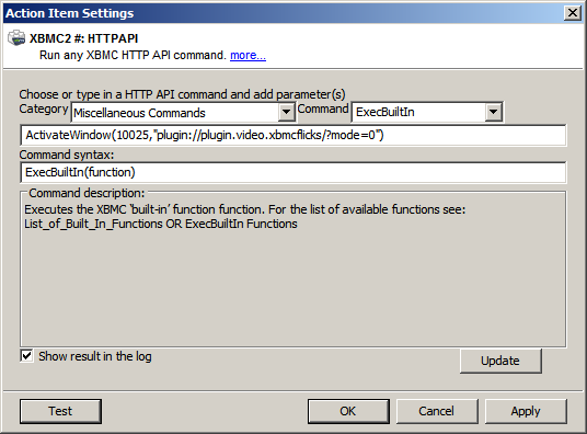

copota wrote:I use the XBMC plugin named "XBMC Flicks" which gives an interface for using NetFlix. I would like to add a command to EventGhost that will start the "Instant Moveis and Shows" for the XBMC Flicks plugin.
You need to add a HTTPAPI action from the XBMC2\Experimental folder then you need to configure it like the screenshot below:
And add this code like in the screenshot:
ActivateWindow(10025,"plugin://plugin.video.xbmcflicks/?mode=0")
I found this code by making the "Instant Moveis and Shows" a favorite in XBMC and then checking the favourites.xml in XBMCs userdata directory.
Hope this is all you need to get it working if not just ask.

Post by copota » Sat Jul 09, 2011 3:23 pm
Thanks for the quick reply.
Your solution worked. At first I was getting errors, since I didn't have "Allow control of XBMC via HTTP" turned on under settings. Once I turned that on, it worked perfectly.

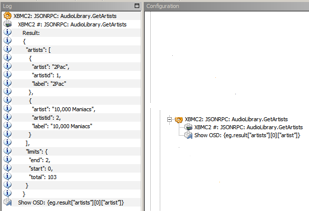

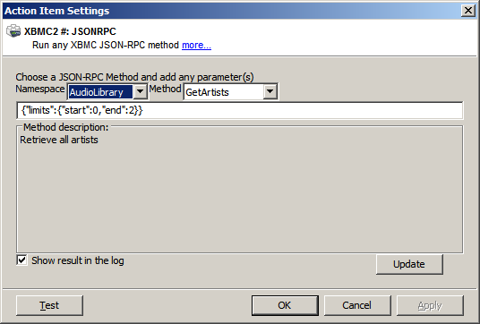

The output in the log is just to show what data you got, to actually use the returned data you use a variable "eg.result" it contains different data depending on what JSONRPC method you use. the eg.result is the standard way you use any returned info in EventGhost and to use in other actions.
Below screenshot shows my test macro and log output:
I limited the GetArtists method to return 2 artists to keep the log short:

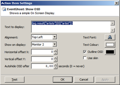

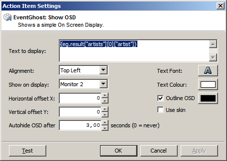

I use the Show OSD action to show the output. To use the eg.result variable in here I need to enclose it with "{}" to access the data in the variable, you don't need to do that if using it directly in Python.
{eg.result["artists"][0]["artist"]}
This shows the first "artist" from the result which is "2Pac" from my log. You need to know a bit about how to work with Python variable types to use the result.
