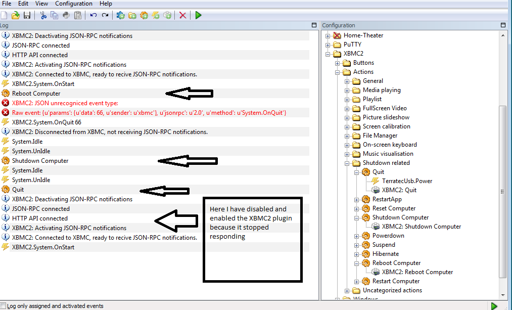

jonib wrote:
Try update2, it should fix and/or give more info about the problem.

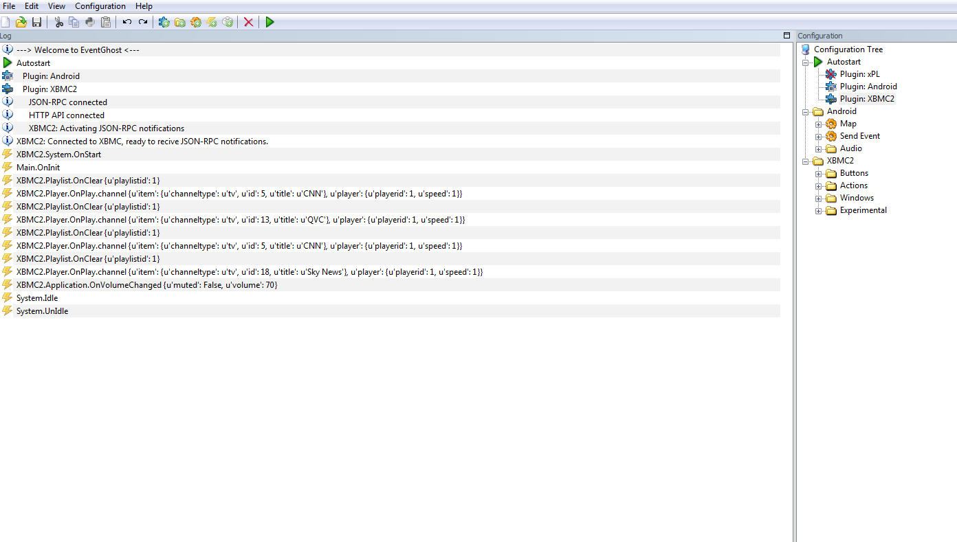

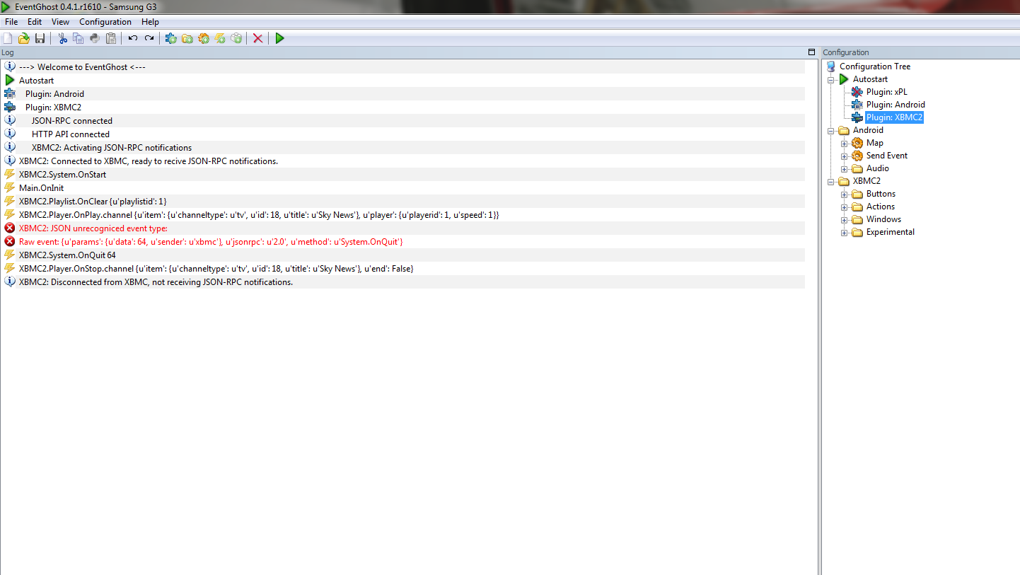

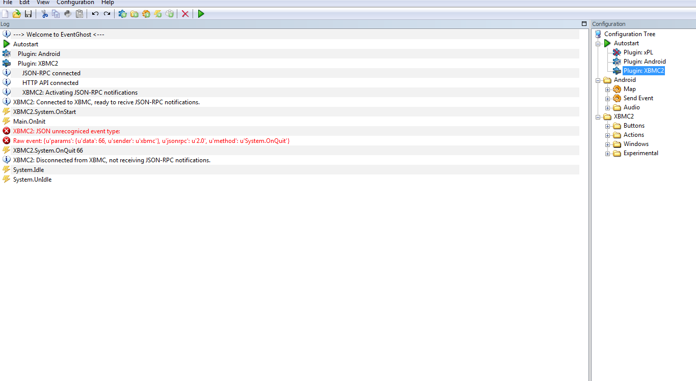

Ok this is what I get when I reboot using the latest version.
Remote reboot (using XBMC Constellation)
This is for shutdown.
Remote shutdown (using XBMC Constellation)
And this for volume change.
Remote volume change (using XBMC Constellation)
I have to inform you that all the above steps the plugin stops responding that I have to restart Eventghost.
N.B I have not tried the above steps using an infrared remote. If anyone has please let us know.
Regards.
Eman457.
Posts: 1345
Post by jonib » Fri May 24, 2013 12:09 am
Thanks for the testing.
eman457 wrote: Ok this is what I get when I reboot using the latest version.
OK, now the event is not crashing the plugin, I'll need to handle the event better though.
This is weird.
Does EventGhost stop responding or only the XBMC2 plugin?
Anyway it looks like I need to put in a lot more debugging code to find out where and why it's locking up. :| But It'll have to wait till tomorrow.

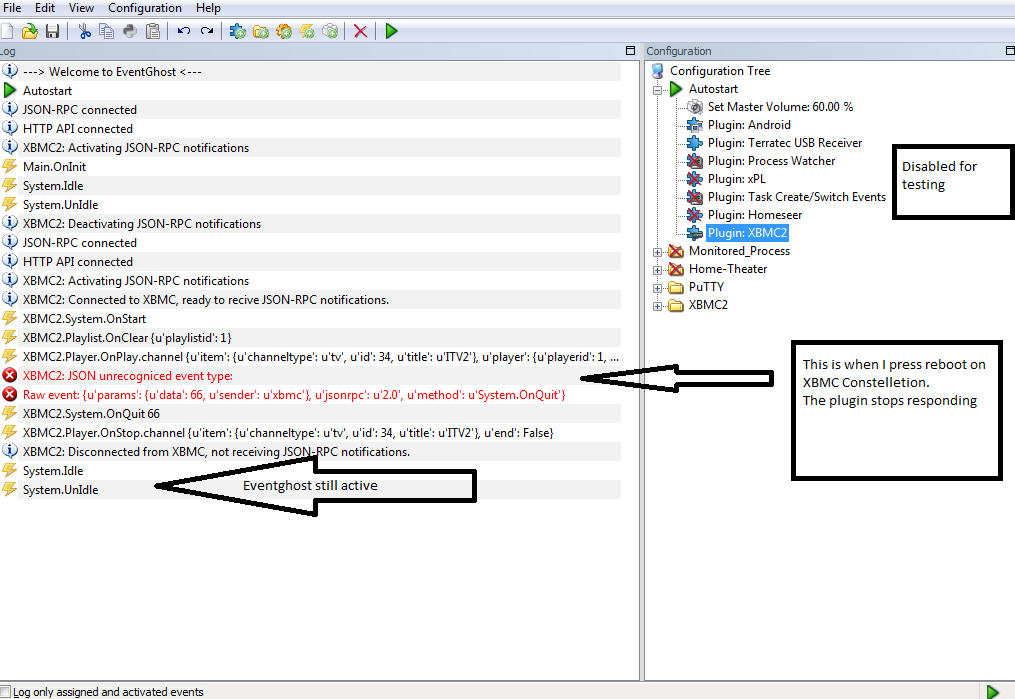

eman457
Posts: 26
Joined: Wed May 22, 2013 10:53 am

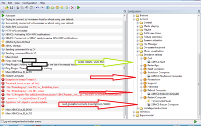

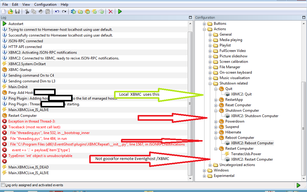

Post by eman457 » Fri May 24, 2013 3:53 am
Hi jonib,
I did some extensive tests using an infrared events with the (shutdown related section) of the plugin. As you can see in the image. Where the green arrow is does not affect the bare metal install of XBMC. But the same command is similar to pressing the X on the XBMC window on Microsoft Windows machine thus closing the application and eventghost staying behind to process the events. The red arrows events will wrap up a Windows machine all together that you don't have to see what is going on in eventghost.
The same commands with the red arrows cause (a bare metal build) XBMC to immediately disengage from eventghost causing those errors. This also happens with the power options from with in XBMC itself. This may also explain why sometimes you have to restart the XBMC Constellation app for iPad in order JSONRPC Notifications to start working again.
Remote JSON-RPC premature disengagement
Regards.
eman457.
Posts: 1345
Post by jonib » Fri May 24, 2013 6:50 am
eman457 wrote: I did some extensive tests using an infrared events with the (shutdown related section) of the plugin.
Is this with Update2? as it don't seem to be and don't help me.

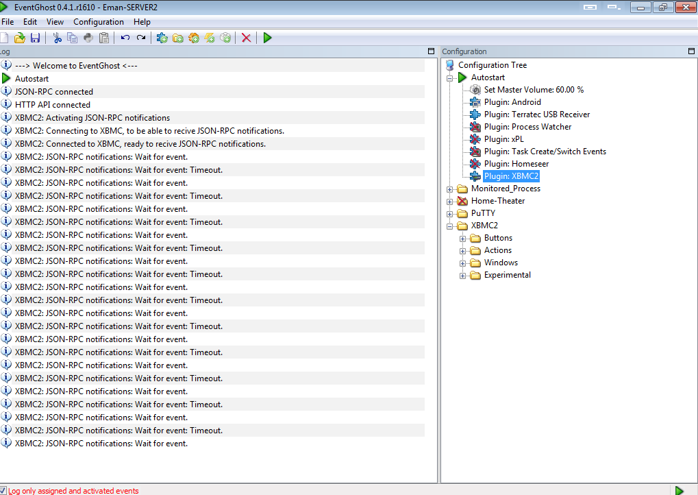

Post by eman457 » Sat May 25, 2013 1:55 am

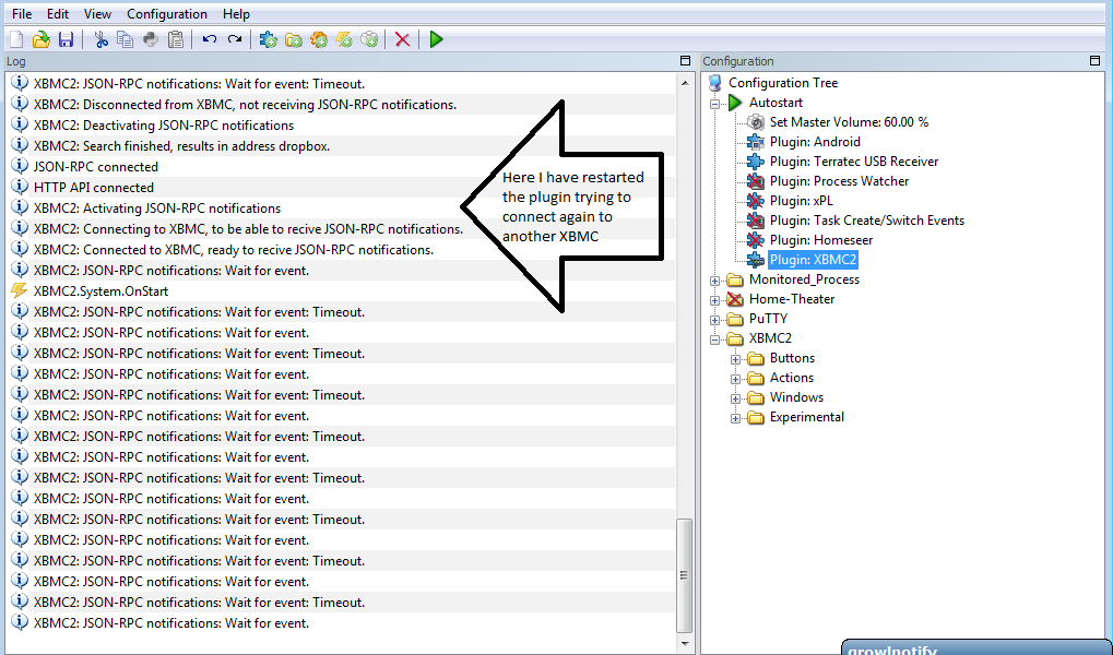

jonib wrote:
eman457 wrote:This one is for the debug file you last posted. It doesn't even give me the chance to do the tests.
What do you mean? Does it lock up right away? The log looks normal for the debug version as I need to know exactly where it locks up, so it prints out much more text.
No man, the log continues scrolling down endlessly as you see in the image. This I think is not normal. So I did no tests. I restarted XBMC and still could not stop the log from scrolling. What you see there is just a small part after I have restarted Eventghost. XBMC is running but does not connect.
Trying to connect!
Regards.
eman457.
Posts: 1345
Post by jonib » Sat May 25, 2013 7:33 am
eman457 wrote:No man, the log continues scrolling down endlessly as you see in the image. This I think is not normal. So I did no tests. I restarted XBMC and still could not stop the log from scrolling. What you see there is just a small part after I have restarted Eventghost.
Well it is normal for the debug version, there is a loop in the plugin that asks XBMC "Hi, do you have an event for me?" and after tree seconds it timeouts and asks again. And as long as XBMC is running and events are enabled you see this.
Based on you log you are connected to XBMC, so you should get events from XBMC.
Is there anything else I'm missing? As it should work exactly like Update2 just much more stuff in the log.

Post by eman457 » Sat May 25, 2013 12:38 pm
No man, it keeps scrolling down endlessly without connecting to XBMC again as you can see in the log.
Snap shot while still scrolling
That's just a snap shot from print screen.
eman457.
Posts: 1345
Post by jonib » Sat May 25, 2013 12:57 pm
eman457 wrote: No man, it keeps scrolling down endlessly without connecting to XBMC again as you can see in the log.
The log show it has connected to XBMC. Are you trying to connect to a different XBMC and that don't work? Sorry, I just don't see/understand the problem.
