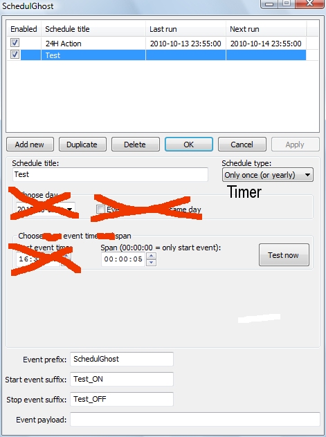

1) The configuration of a schedule to work as an egg-timer works as you described but it is for the user not 100% intuitive, if possible I would suggest to add a set-up page that looks like the picture below
A new type of schedule "Timer" is selected and then the new page is displayed

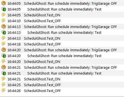

2) When I start the schedule the start event and stop events are correctly generated but idf I restart the schedule before it stopped, I get two instances running. I think there should be a kind of "abort at restart" so that the first is stopped and then it is restarted. See the part of the log below

1) For this proposal I do not have a great understanding. The schedule, which is defined in such a manner is really no schedule.
Do not belong among the other types of schedules. And last but not least, this would mean big changes in the code.
I think it will be better at the appropriate place to put a meaningful tooltip, or to create a detailed wiki page and put a link to the wiki page on this tooltip.
2) For this problem I look soon, it will probably not difficult.

I noticed that when you select a schedule type from the drop-down list, you change the content of the GUI dialog. I thought it would not so much code work to add another schedule type that could then have the GUI I tried to indicate with the picture above. If every new schedule type cause a lot of code changes, I understand if you try to avoid it
Anyway, if you would add a new type, you should of course set the necessary variables by the code like an old start date etc to make the function work. What is a problem from useability point of view is that I have to set (for the user) meaningless variables just to make the thing work. Of course tool-tip and wiki's can help but it is not an elegant solution
I think the plugin you made is elegant and deserves elegance everywhere...
This is a matter of opinion. Mine is that it could very well belong here as a schedule type. It is actually a scheduling you are creating with a start and stop event. Also the egg-clock is in fact a kind of schedule

Dear Walter,
Okay, you persuaded me. I will try to implement your proposal in its entirety.
I have an idea how to avoid such a large change in the code, which I feared. Perhaps it will be possible to do so.
Best regards, Pako.

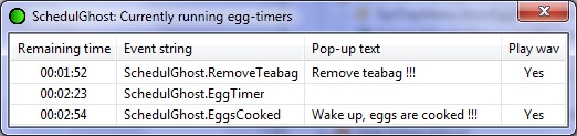

New version 0.0.6 released. News:
- added action "Show currently running egg-timers"
