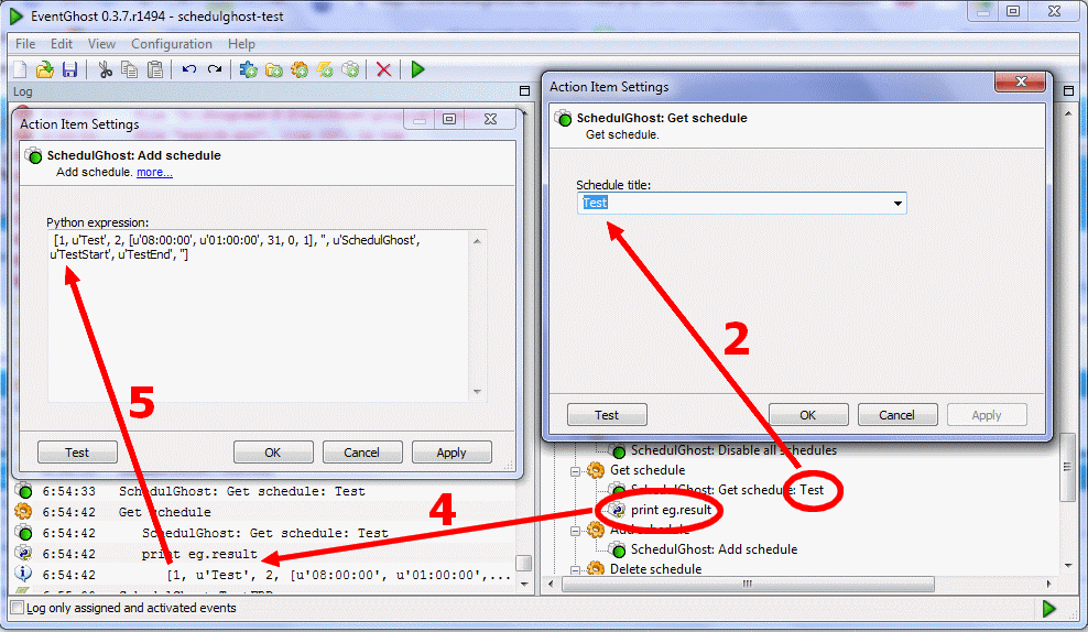

Post by Pako » Wed Apr 13, 2011 9:35 am
cfull1 wrote:Hey Pako, I'm confused how to use AddSchedule normally in the edit box.
Could you give me an example?
Of course I can.
I thought that the description of action Add schedule explains it well enough. But it seems not. Never mind, I'll try to explain it.
The following picture is a good thing to see.
You can do the following:
1. Open SchedulGhost manager and create a schedule (I called it Test)
2. Double-click on Get schedule. In the dialog, choose your schedule (Test)
3. Add the action Python command (command = print eg.result)
4. Run the macro Get schedule. In the logger will appear a row with definition of schedule
5. Use Copy/Paste to transfer the definition to dialogue Add schedule

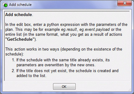

If you add a schedule with the action "AddSchedule" of SchedulGhost, the added schedule will not be saved in SchedulGhost.xml.
I need this function, therefore I have written an addition to the code of SchedulGhost, which adds an action, which saves the added schedule in SchedulGhost.xml.
class DataToXML(eg.ActionBase):
    def __call__(self):
        self.plugin.dataToXml()
    Actions = (
        (DataToXML, "DataToXML", "Save data to xml", "Saves data to xml.", None),
I have also written an addition to the description of the action "AddSchedule".
descr = u'''<rst>**Add schedule**.
In the edit box, enter a python expression with the parameters of the plan.
This may be for example *eg.result*, *eg.event.payload* or the entire list
(in the same format, what you get as a result of the action **"GetSchedule"**, see the documentation of
the python expression in this description.
This action works in two ways (depending on the existence of the schedule):
1. If the schedule with the same title already exists, its parameters are overwritten by the new ones.
2. If the title does not yet exist, the schedule is created and added to the list.
An added schedule will not be saved automatically in SchedulGhost.xml. To save the added schedule use the
SchedulGhost manager or the action "DataToXML".
This is the syntax of the python expression::
[enabled?, u'scheduleTitle', scheduleType, [expressionScheduleType], u'dateLastRun timeLastRun',\
u'eventPrefix', u'startEventSuffix', u'stopEventSuffix', u'eventPayload']
These are the different schedule types and them expressions:
* 0 (only once (or yearly)): u'startEventTime', u'span', u'date', repeatYearly?
* 1 (daily): u'startEventTime', u'span'
* 2 (weekly): u'startEventTime', u'span', daysWeek, DoNotTriggerOnAHoliday?,\
TriggerNotChosenDayOnAHoliday?
* 3 (monthly  / weekday): u'startEventTime', u'span', daysWeek, monthsYear(Jan-Jun),\
monthsYear(Jul-Dec), DoNoTriggerOnAHoliday?
* 4 (monthly / day): u'startEventTime', u'span', daysMonth(1-8), daysMonth(9-16),\
daysMonth(17-24), daysMonth(24-31), monthsYear(Jan-Jun), monthsYear(Jul-Dec)
* 5 (periodically): u'startEventTime', u'span', u'date', periodEventRepeat, timeFormat
* 6 (time span): u'00:00:00', u'span'
Explanation:
* enabled? = boolean expression if it is true or false (0 = false; 1 = true)
* u'scheduleTitle' = expression with a unicode string (wake_me_up)
* scheduleType = a number
* date = year-month-day (2012-12-31)
* time and span = hours:minutes:seconds (23:59:59)
* daysWeek = sum of the days (Monday = 1, Tuesday = 2; Wednesday = 4, ..., Sunday = 64)
* monthsYear(Jan-Jul) = sum of the months (January = 1, ..., June = 32)
* monthsYear(Jul-Dec) = sum of the months (July = 1, ..., December = 32)
* timeFormat: seconds = 0, minutes = 1, hours = 2, days = 3, weeks = 4, months = 5, years = 6
Make sure to use backslash' instead of ' within a string literal if you use this function in a python script.
Could I commit these code additions to the SVN repository?

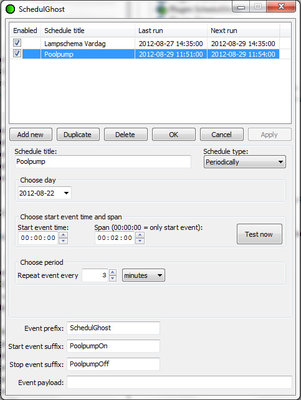

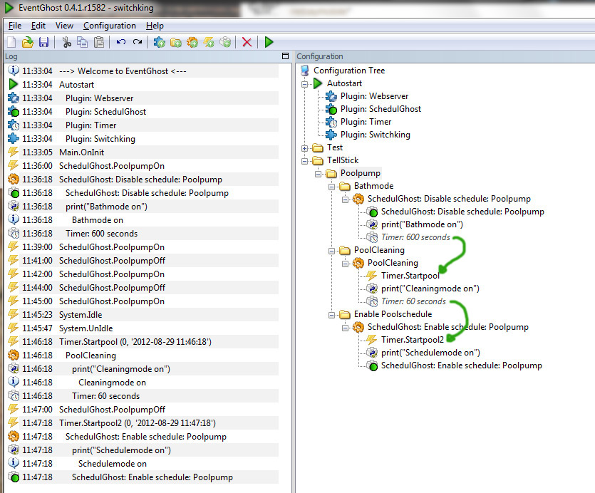

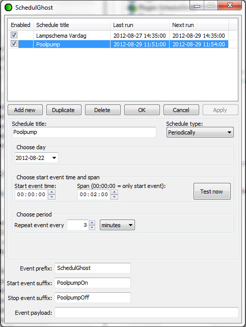

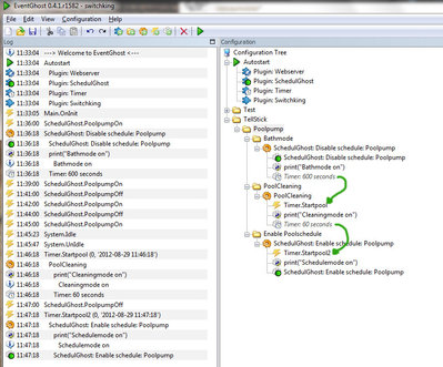

Hi, I can't get the disable-function to work properly.
I have this schedule running:
And it's working perfect.
But as you can see, when I execute the macro "Bathmode", the schedule Poolpump sets to be disabled for 11 minutes (10+1) in total. But it's not working, the schedule keeps sending ON-events anyway.
From the Schedule-logg:
2012-08-29 11:33:04 SchedulGhost plugin started. All valid schedules will be scheduled:
2012-08-29 11:33:04 Schedule "Poolpump" scheduled. Next time: 2012-08-29 11:36:00.
2012-08-29 11:36:00 Schedule "Poolpump" - Start event triggered. Next time: 2012-08-29 11:39:00.
2012-08-29 11:36:18 Schedule "Poolpump" canceled (disabled).
2012-08-29 11:39:00 Schedule "Poolpump" - Start event triggered. Next time: 2012-08-29 11:42:00.
2012-08-29 11:41:00 Schedule "Poolpump" - Stop event triggered.
2012-08-29 11:42:00 Schedule "Poolpump" - Start event triggered. Next time: 2012-08-29 11:45:00.
2012-08-29 11:44:00 Schedule "Poolpump" - Stop event triggered.
2012-08-29 11:45:00 Schedule "Poolpump" - Start event triggered. Next time: 2012-08-29 11:48:00.
2012-08-29 11:47:00 Schedule "Poolpump" - Stop event triggered.
2012-08-29 11:48:00 Schedule "Poolpump" - Start event triggered. Next time: 2012-08-29 11:51:00.
It seems like the schedule turns back to enabled by itself and keeps running. And no "enabled" line can be found in the Schedule-log either at 11:47:18.
BUT, it seems like the schedule doesn't trigger any OFF-event when disabled (should have triggered a OFF-event 11:37:00). But they start to be triggered again as soon as the ON-events starts.
Have I done something wrong in my setup or is there a bug in the disable/enable-function in the plugin?
Best regards
Johan
Re: SchedulGhost
Post by Pako » Thu Sep 06, 2012 5:08 am
Thank you for your bug report. I am a long time could not find a bug.
Finally, I found that the problem occurred only when the action "Disable schedule"
was executed between the start and stop events (but not always).
Corrected version can be downloaded from the SVN repository.
