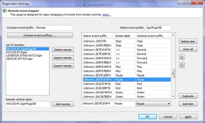

This plugin is designed for easy remapping of events from remote controls.
Using this plugin has several advantages:
1. This facilitates the transition from one type to another type of remote control
(or from one type of IR receiver to another type with the same type of remote control).
If you change your remote control, you need not go through the whole configuration tree
EventGhost and to all macros add new event string. Now you just add the new remote
control into a plugin Remote event mapper.
2. It facilitates the exchange EventGhost configuration files between users
3. If a remote control triggers two different events for each button (toggle-bit behavior),
the plugin allows you to use for each macro only one event
4. It makes configuration tree more comprehensible
The plugin allows you to export a conversion table for each remote control to an XML file.

I installed and trying to set it up. I cannot figure out how to use it? Do I need to learn/send each IR signal? Since I already sent each signal and have them in the Context section, can I simply drag or copy them to your plugin? It would be very time consuming to re-learn all the commands I already have setup.
can you white up a short How-to?
Posts: 1298
Re: Remote event mapper
Post by jonib » Sat Dec 04, 2010 8:19 pm
Livin wrote:Do I need to learn/send each IR signal?
Any you want to remap you need to relearn.
Yup, but the next time you will only need to learn ones.
Step 1: Type name of remote in "Remote control name:", press Add remote. Now select the remote in the "List of remotes" list.
Step 2: Type in the event prefix that your remote plugin uses in "Native remote prefix:" (The part of the remote event that don't change)
Step 3: Press "Add item" then press the button of the remote you want to remap, then type in the remote button name ("Button label"), then type in the desired event suffix to remap to. ("Common event suffix")
Now when ever pressing the remapped button it will create a new event ("Common event prefix").("Remapped event suffix")

I finally had a chance to try this out and great job Pako.
Damn, I wish I had this three remote plugins ago, would have saved me some unnecessary work. (as in I have had to reprogram all my stuff for three different remote plugins)
It took me a few moments to get how to do the config but when I got it it's almost perfect. :wink:
Unfortunately doing the buttons one at a time was not for me so I did a couple to see that it worked then I exported the remote config and did the rest of the buttons in an editor. I don't know if it was faster but I hate doing the same thing 40 times. :twisted: then I imported the .XML file and it works great.
I have one suggestion (and if you don't do it I will 8) ). There should be a button "Auto remap" that uses the list from "Common event suffixes" and asks to press a remote button to map to each suffix one by one. So first it shows for example Play then I press the Play button on the remote, then it shows Stop I press Stop on the remote, and then if my remote don't have that button I can skip by pressing a "skip" button or a button I have already mapped before to skip to the next. This would make it much faster to remap most buttons.
