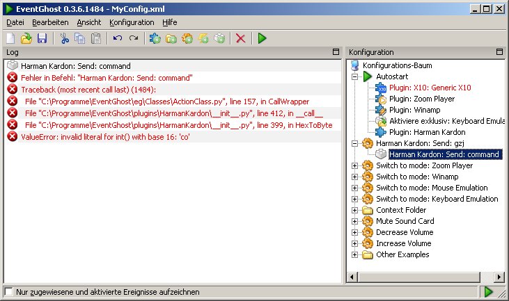

Harman Kardon plugin is now errorless to activate in eventghost. It opens a dialog box and I have to type the command what I want to send on AVR. I dont know any syntax of commands wich HK AVR needs. I typed "test".
There are just now a new problem. When I click "run" for "test" command, a lot of error messages tell me eventghost. Look new screenshot.
How we can fix this error?

Problem is: Event Ghost dont send any command. Event Ghost tell me a lot of error messages. I switch EventGhost in english language and paste the messages directly here for you:
Error in Action: "Harman Kardon: Send: # POWER ON 80 70 C0 3F "
Traceback (most recent call last) (1484):
File "C:\Programme\EventGhost\eg\Classes\ActionClass.py", line 157, in CallWrapper
File "C:\Programme\EventGhost\plugins\HarmanKardon\__init__.py", line 412, in __call__
File "C:\Programme\EventGhost\plugins\HarmanKardon\__init__.py", line 399, in HexToByte
ValueError: invalid literal for int() with base 16: '#P'
What's the reason of this errors? How I can repair this lines?

No worries, I think I just wasn't clear enough about the way the commands work. The plug-in is expecting a 4 byte code, and doesn't have error handling for anything else. Just use the 4 hex numbers at the end instead of the whole line:
Comment Command
Just use the 80 70 C0 3F part.
You're almost there!
~K

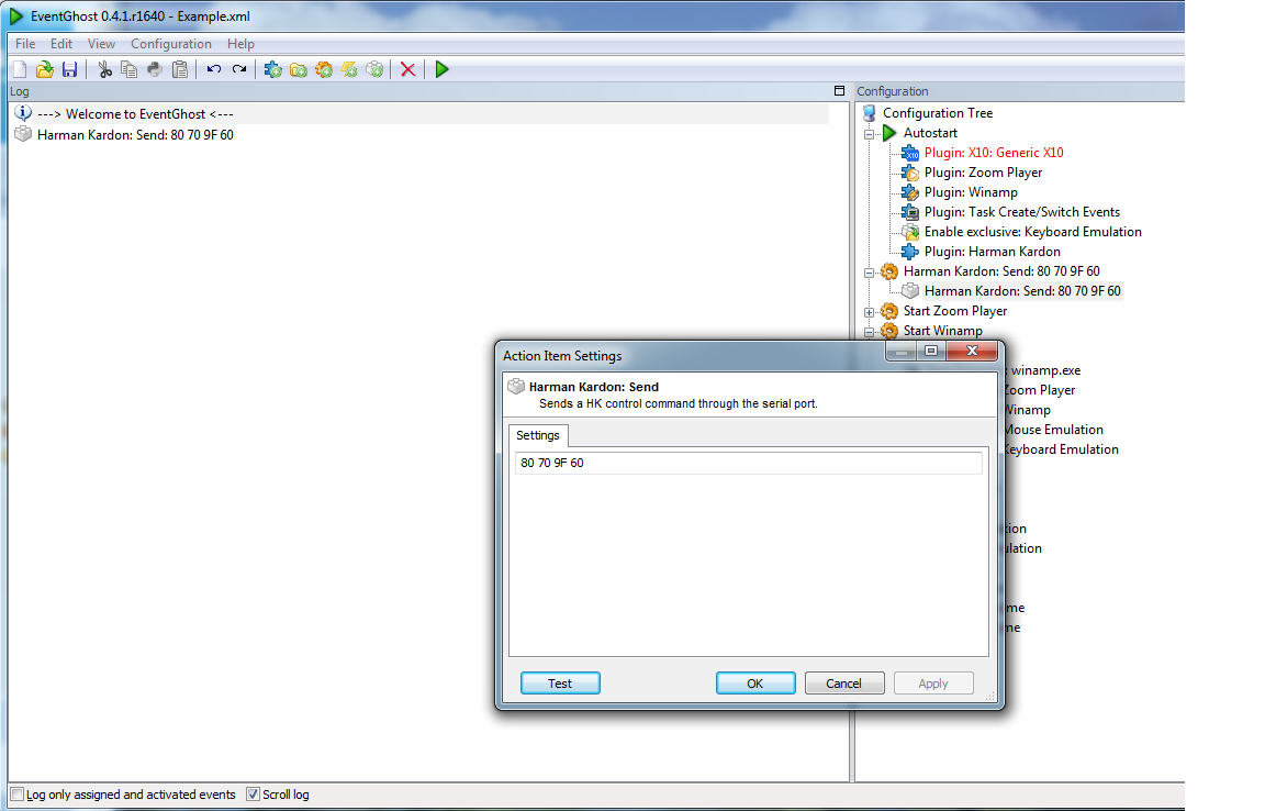

Hello All,
Hope someone's still watching this thread. I added the plugin to use my Harman AVR 247. Plugin installed successfully. Plugin set as COM1, Baudrate at 38400, Number of bits 8, Parity: No Parity, Stopbits: 1, Flow control: None, Generate events on incoming data unchecked.
When I execute 80 70 9F 60, to turn it off, nothing happens.

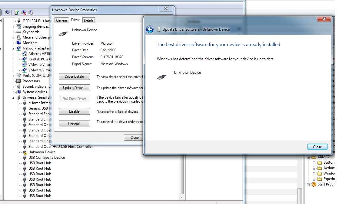

just a few updates on my last post, this is how usb to serial appears on my system.

Hello. I changed to a different Serial to USB cable, no more ! on my devices. I followed instructions by another to set baud rate to 38400, and still it wasn't working. I have "HK" as prefix set.
When I send commands, it's not responding to it. When I turn off or on the receiver, no events is logged in the window.
I then replaced the serial to usb with a serial cable, from HK's rs232 connected to my pc. Still, no event is being logged whenever I do a power on and off.
Hope someone can help.
