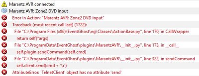

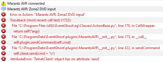

Installed fine. Bug on sending commands:
I don't have time to setup remote access tonight, but can do tomorrow if needed to resolve.

Yeah it was a fat finger.. supposed to be Send. not send
fixed version is attached.. I can only test as far as opening the plugin. unless i set up a couple of telnet servers. but i will not get answers and what have you. so it's really pointless
