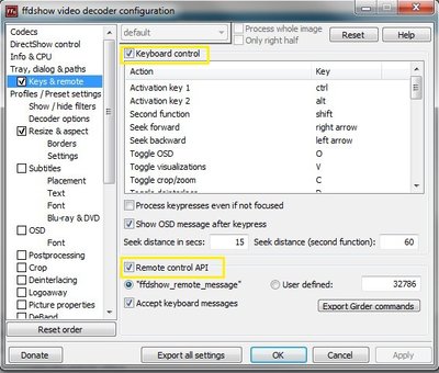

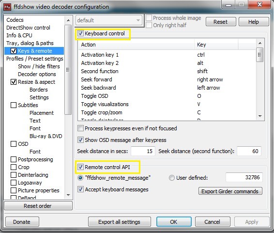

No I had not. That fixed the problem.
I thought it would be something simple :)
Could be a good idea to include that information in the description of the plugin.
Thanks a lot.

I can't get this plugin to work. Everytime I want to use a command I get the same error message. "Application is not running!"
I installed many different Versions of ffdshow but nothing seems to work. Do I have to configure anything in the plugin like the path or so ?
Luca Brasi
Posts: 262
Re: ffdshow
Post by Luca Brasi » Tue Jun 29, 2010 2:13 pm
Have you set up ffdshow like this:
