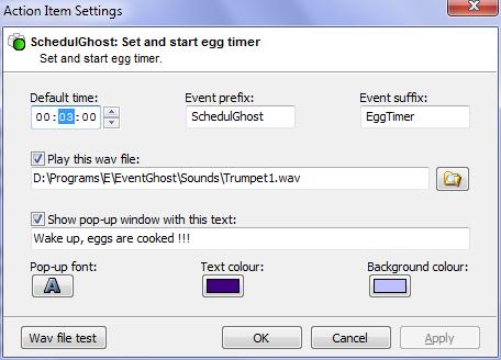

After some time I come with a new plugin. It is basically a scheduler (but with extra features egg timer).

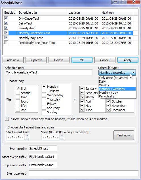

1) I think it is better able to manage all the schedules and timers in one place (using a single configuration dialog),

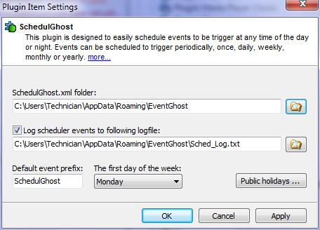

3) The plugin has a built-in option to log its events into a text file.

5) Is it possible to have more Egg timer with individual settings
6) All schedules and timers can be individually or collectively, to disable or enable with the use of actions. With other actions is also possible to add and delete schedules (without opening the configuration dialog).

I think a lot more than words can tell you pictures.
Due to the limitation of the number of attachments for other pictures I make a new post.

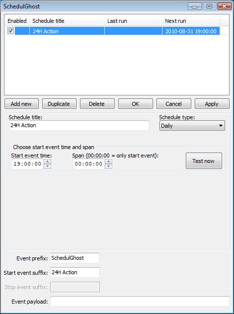

I would like very much to use your timer plugin, however, I am a bit new to EventGhost, Would anyone be willing to post an example?
I would like to set the timer to perform an action every 24 hours. Could someone show me the steps and how to fill out the various options?
Mark
Re: SchedulGhost
Post by krambriw » Tue Aug 31, 2010 6:11 am
Hi, you need to run the macro "Show SchedulGhost". It will bring up a dialogue where you can add a schedule with your settings like the example below. The example will run and every day at 19 it will create an event that you can add to your macro with further actions inside

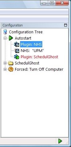

I have a configuration whith multiple plugins and I get the following error seen below. I could avoid the error if I positioned SchedulGhost as the first plugin in the tree Autostart
However, I think there is something that might cause problems, maybe you could add a retry in the code somewhere
Best regards, WAlter

Post by krambriw » Mon Sep 20, 2010 3:27 pm
Hello Pako,
Lets see if you can recreate the same problem
The picture below shows my configuration. Besides your SchedulGhost I have a special private plugin called NHS that I use to monitor UPM temp&humidity sensors in my house and do some calculation on received data
With the configuration as is, I get the problem reported. If I move your plugin to be first in Autostart, the problem goes away

Post by Pako » Mon Sep 20, 2010 4:47 pm
Hi Walter !
Thank you, but I still can not replicate your situation.
During what operation (in which moment) you will receive this error message?
The same problem occurs even when in the configuration is instead of NHS another plugin?
Re: SchedulGhost
Post by krambriw » Mon Sep 20, 2010 5:31 pm
The error comes right away at startup of EG. I think it is because of a conflict with NHS
I have tested with other plugins but it is only mine that causes problems. Running under Vista best to mention ;)
