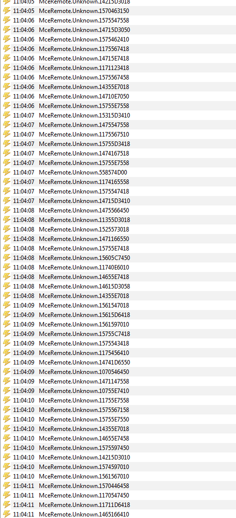

Yes, that's correct, I assigned a few functions to EG using .Unknown, however I am unable to use directional keys or keys that I need to press in succession. While EG accepts MceRemote.Mce.Num2 commands pretty fast, it requires a small pause before you can press MceRemote.Unknown.1342C8 again. If you have a remote lying around, an old TV remote, or something that's not sending MCE commands, try it.

MartyMc wrote: Yes, that's correct, I assigned a few functions to EG using .Unknown, however I am unable to use directional keys or keys that I need to press in succession. While EG accepts MceRemote.Mce.Num2 commands pretty fast, it requires a small pause before you can press MceRemote.Unknown.1342C8 again. If you have a remote lying around, an old TV remote, or something that's not sending MCE commands, try it.
I don't seem to have that problem as you can see from my screenshot. But even if you do, why not just use MceRemote.Mce.Down etc. for the direction keys? The autorepeat in my .xml works well with it too.
By the way, I take what I say back in above quote, running Win 7 Pro, I installed win 7 Mce plugin first, then I installed regular non win 7 plugin, clicked on disable HID, and then removed the plugin, this disables WMC hard-coded commands. If I want them enabled, I just install non-Win7 plugin, and check then uncheck HID, then I remove the plugin, this enables it.
Cool, I've used both plugins, the non win7 MCE needs to be run as administrator, but otherwise they work the same, as far as I remember.
