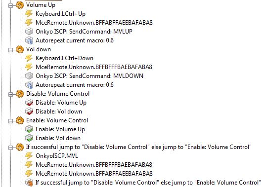

Re: added TriggerEvent IF to EG
Post by blaher » Tue Apr 05, 2016 5:08 am
Thank you, I'll see if I can incorporate it into my setup.
Hmmm, looking at it, it's going to be a bit harder to differentiate between the two.
Here's a pic of what I mean: The first remote signal trigger is with no EG signal being sent via the network. Volume goes up once.
The second part after the EG volume macro is enabled, volume goes up twice.
But the only difference seems to be the volume change via the network is updated before the IR signal is received, but I don't know how consistent that is.
If I get a volume change before a remote trigger I could disable the EG part for 10 seconds, or so, I guess.
Something similar to the pic below, but obviously the logic is missing. :/

Post by kgschlosser » Tue Apr 05, 2016 12:16 pm
ok
your problem is simple.
ad a wait in there after the first proper one hits.
make it like no more then 0.1 for a wait time
that will stall all events from triggering
then right after that wait put the flush events in there or clear events... whatever the hell it's called.
that will clear all events that are pending because of the wait.
that should cure your problem.
