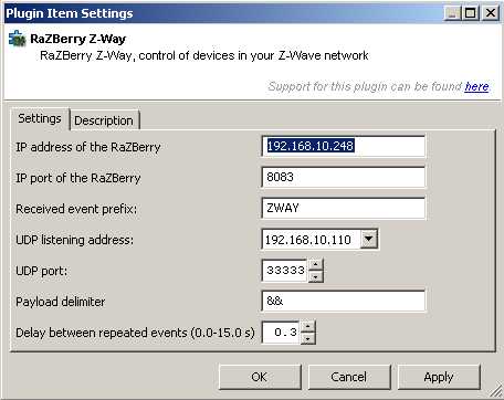

Yes, sure, I made a plugin some time ago and I am using it since then, works fine
- you can control switches on/off and set dim levels
- you receive status updates as events when statuses are changing
- I have sensors that gives temperature readings and input events
- you can monitor the communication with devices, you get events if you loose communication
To receive events as notifications when they happen, without polling, I have added a python script in the Pi and this is executed by the Z-Wave when statuses are changing. Earlier I send them out on the network via UDP broadcasts, today I have changed to use MQTT instead and combine that with my MQTT Client plugin in EG. This works really well.
From my log:
08:46:39   Main./eventghost/zwave 'Device_3_Instance_3_temperature, 14.25'  #a temperature sensor
08:46:45   Main./eventghost/zwave 'Device_3_Instance_2, false'  #an input triggered
08:46:46   Main./eventghost/zwave 'Device_3_Instance_2, true'
08:46:57   RaZBerry Z-Way: Set Binary Power: ZWAY|2  #a switch turned on
08:46:58   Main./eventghost/zwave 'Device_2_Instance_2_off, 0'
08:47:00   Main./eventghost/zwave 'Device_2_Instance_2_on, 255'
08:47:05   RaZBerry Z-Way: Set Binary Power: ZWAY|2  #a switched turned off
08:47:06   Main./eventghost/zwave 'Device_2_Instance_2_on, 255'
08:47:08   Main./eventghost/zwave 'Device_2_Instance_2_off, 0'

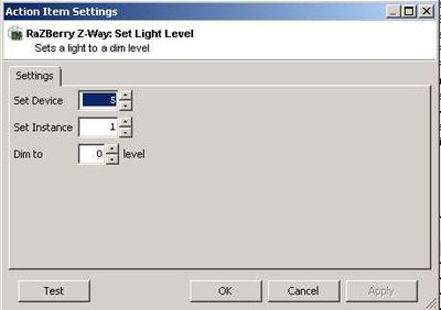

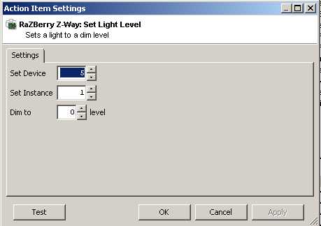

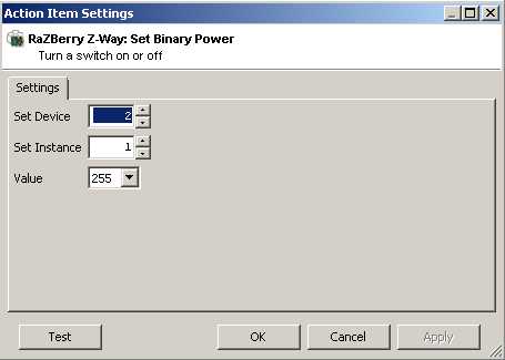

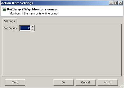

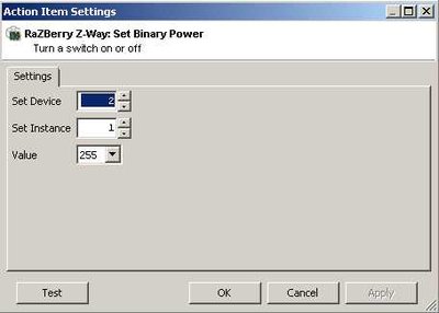

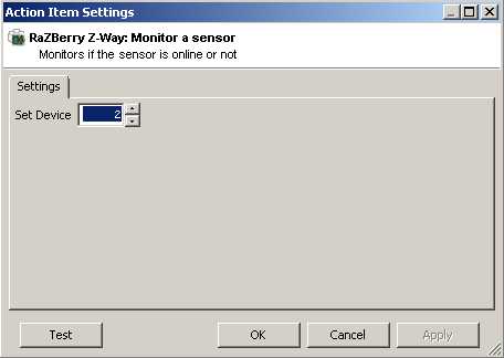

Below some screen shots
