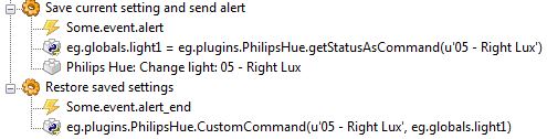

Post by Aquila » Mon Mar 16, 2015 11:25 pm
Just to show how to use the getStatusAsCommand function:

If you want to restore the light status after flashing an alert. This is how to do it:
Note that you have to trigger some kind of event for each macro. If you don't have an event when the alert is supposed to end you can use the timer plugin.
