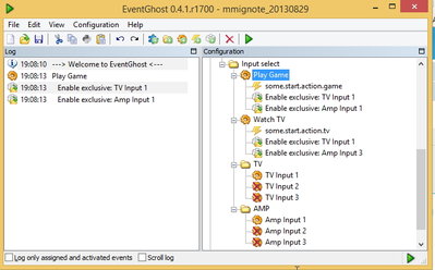

My proposal for something like this would be

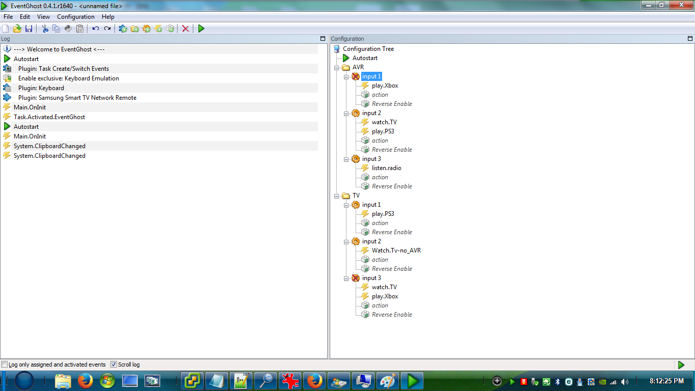

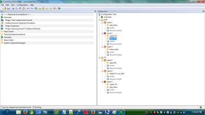

Post by Sat32 » Thu Apr 30, 2015 12:23 am
Here if the event "watch.TV" is fired this would be the result.
then if "play.Xbox" is fired this would be the result
Do you understand how I'm trying to use this??

No I want a plugin that will do the opposite "enable exclusive"
results of both aimed at input3

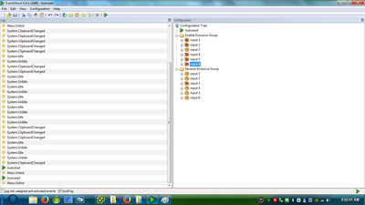

OK I made a Plugin for it.
it's located here
viewtopic.php?f=9&t=9140
Have fun.
