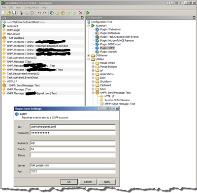

here's a plug-in which connects to a Jabber server (eg Google Talk), and transforms received messages and online statuses into events.
It also let's you send messages through actions.
Received messages get transformed into 3 events:
XMPP.Message | Test
XMPP.Message | [email protected] | Test
XMPP.Message | [email protected]/resource | Test
so that you can choose the required granularity for each message
and online statuses look like
XMPP.Presence | Online | [email protected]/device1
XMPP.Presence | Online | [email protected]/device2
XMPP.Presence | Offline | [email protected]/device2
XMPP.Presence | Online | [email protected]/somedevice
I'm using it to automatically lower the volume on my netbook when the main machine is turned off, because I usually plug in the headphones into it after turning it off. And when the main machine is turned on, the volume on the netbook is set to 100% because I then usually plug it into a mixer which requires the full audio level.
I'd appreciate to get some feedback.
