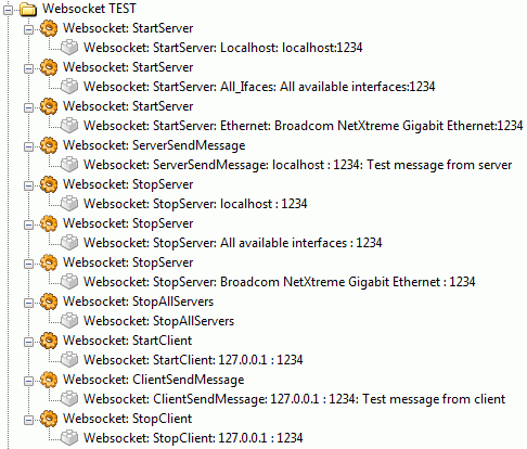

Re: Websocket Plugin
For several days, I deal with it.
I think it will go.
I'm just not sure if it will have some sense because here are plugins Webserver, Network sender, Network receiver and Broadcaster.
Thank you for your explanation, now I understand it much better.
BTW - your new version (0.9.2) I did not get to work.
But I'm not going to deal with it. Meanwhile, I worked on my implementation.
It even allows to run multiple servers (with different or the same functions) on various network interfaces / ports.
And also has the function of the client, so this plugin can be used for "communication" between two (or more) EventGhost.
But it still requires a lot of work to do.
BTW - I also proceeded to use select.select, but in another place.

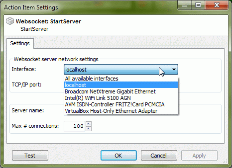

Pls write some lines how you would configure. Its ok to add the plugin and to create an action to send message. But where do you want the html page placed? Is the EG web server plugin needed too?

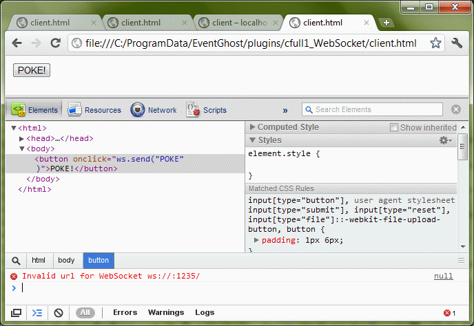

I added client.html to the EG webServer root.
I then opened the html in Chrome:
What is the desired result?
Manny

Pako wrote:Well, probably it will be easier if I find why it does not work for me ...
So I figured it out. I proceeded as follows:
1. I found that my PC the expression "socket.gethostbyname(socket.gethostname())" evaluates to 192.168.56.1 . This address has a virtual adapter "VirtualBox Host-Only Ethernet Adapter".
2. I am instead of "socket.gethostbyname(socket.gethostname())" use empty string "" (ie All available interfaces). Unfortunately, even now it did not work. BTW - which browser you use? I used Chrome or Black Hawk. Both behave the same - it reported an error - see picture:
3. I replaced expression "window.location.hostname" in the file client.html by string "127.0.0.1". Now it has been a little better. Server response to client connection, but immediately disconnected. Chrome now reported error as follows:
4. In the plugin file and it the file client.html I replaced the host address
by the fixed IP address of my WiFi interface ("192.168.178.21") and voila - it started to work!

my mistake. I tried to simplify things last minute with socket.gethostbyname(socket.gethostname()). I uploaded a new version allowing you to give the host ip address. As long as this address and the address listed in the html client are the same it should connect. I use chrome, and safari on my iphone.
If you are still having problems try loading the html file through that ip address and not "localhost" or "file:///". As part as the websocket security it has to make sure its all the same.
It should be noted currently websockets are not supported in internet explorer. I'm not sure about firefox. Chrome and Safari work fine though.
