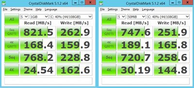

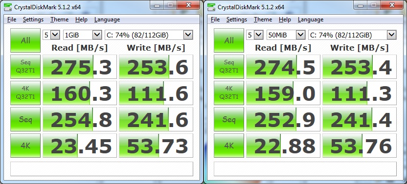

I have run benchmarks to check hdd performance. and these are the 2 computers. and i have pretty much narrowed it down to stackless
the first image in each set is a 1gig test and the second is a 50mb test and the first column in each is the read tests. and the second is write tests.
as far as the write tests go they are very close in numbers. but there is one difference. computer 1 has write caching turned off and computer 2 has it turned on.
this is done because before i had a battery backup i didn't want to have any data corruption on computer 1 if i lost power. this can happen because of the raid. i honestly forgot up until now that it is in fact turned off. so the numbers being the same indicates that computer 1 is faster at writes than computer 2 because basically computer 2 is intentionally handicapped and the numbers are almost the same
computer 1
computer 2
computer 1
computer 2
