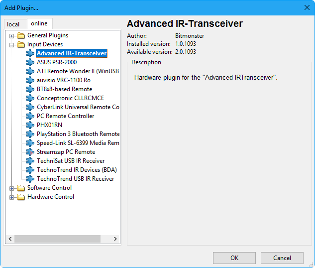

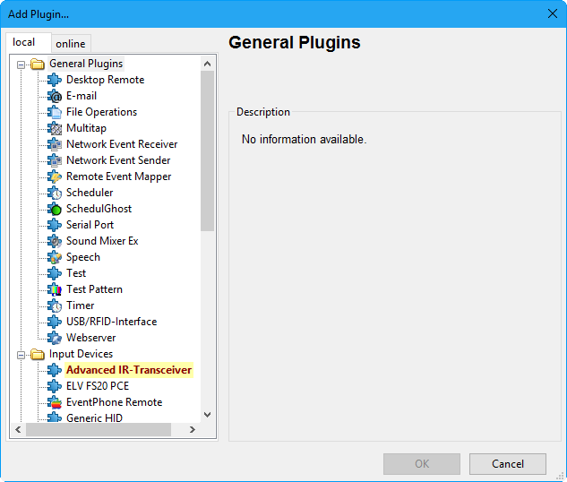

2016-11-07 20_17_13-Options.png (8.31 KiB) Viewed 5942 times
Testversion (Updated 08.11.2016)
Source code
The online database for this test is on a server i rent from a hoster.
I haven't yet searched the forum for plugins to add them to the list.
If you have problems, suggestions, wishes, remarks, etc... let's talk about it 8) There is at least one thing to do: make a backup before plugin upgrade if something fails. And i'm sure there are more...
This is not the official way to go. :wink: It's just my version. And it's only the EG part. The online part for adding plugins to the repo is missing, so manually adding it through phpMyAdmin (or something similar) is needed.
