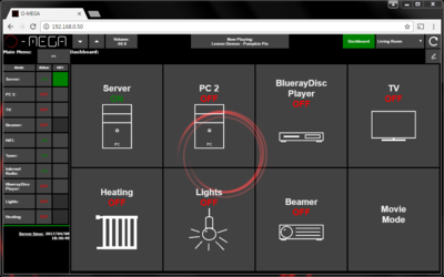

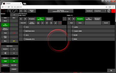

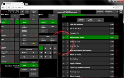

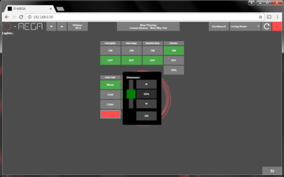

Since pictures say sometimes more than 1000 words, here are some screenshots:
Dashboard
Dashboard
AIMP template
AIMP template
File browser
File browser
Lights
Lights
