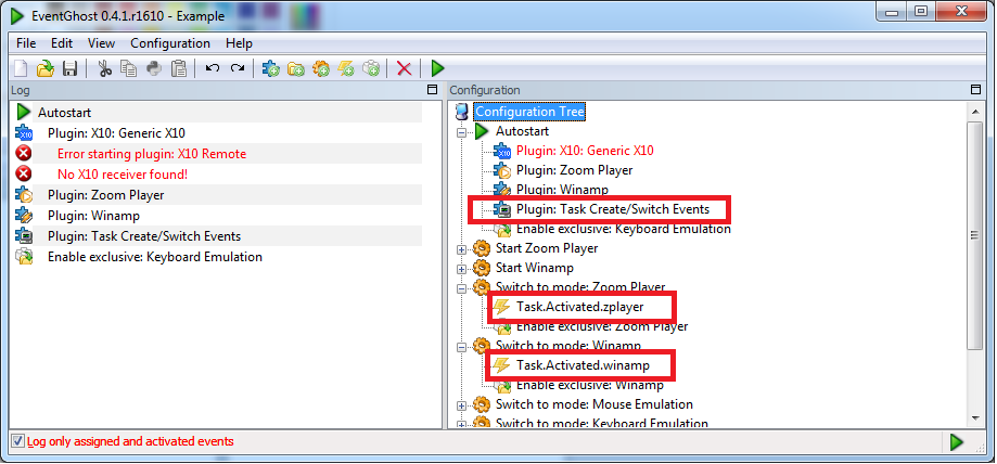

The included EventGhost config "Example.xml" has examples how to use the same buttons for different programs. With Add action\EventGhost\Enable an item, Disable an item and Exclusive enable a folder/macro.
Then you can use "process watcher" or "task create/switch events" plugins to detect what "profiles" to activate automatically.

Unless you are looking at a different Example.xml that is not in the EventGhost install dir, example.xml is the example I'm referring to. The "Context Folder" contains the macros for the specific programs you want to control. The "Switch to mode..." macros contain the action to enable the macros for the currently active program.georgeimnot wrote:I found example.xml and looked at it, but I couldn't find the example you are referring to.

That's the correct one. Have you read through the EventGhost documentation especially the "Short manual"?georgeimnot wrote:Attached is the example that I have. I guess my problem is I just dont understand how these things work. Is there anyone willing to walk me thru what I need? Sorry if I'm a noob and the example doesnt jump put at me with what I'm looking for.

Well, I suggest you put your glasses on as that plugin is used in the example.xml, that is a big part why I suggested that you look at it.georgeimnot wrote:The example.xml that is included with the program did not use this plug in. This plug in makes what I was looking for nice and easy.

When I open the Example.xml YOU posted this is what I get:The "Task Create/Switch Events" plugin is clearly loaded and used.If YOU look at the example.xml that I posted, there is no Task Create/Switch Events.
