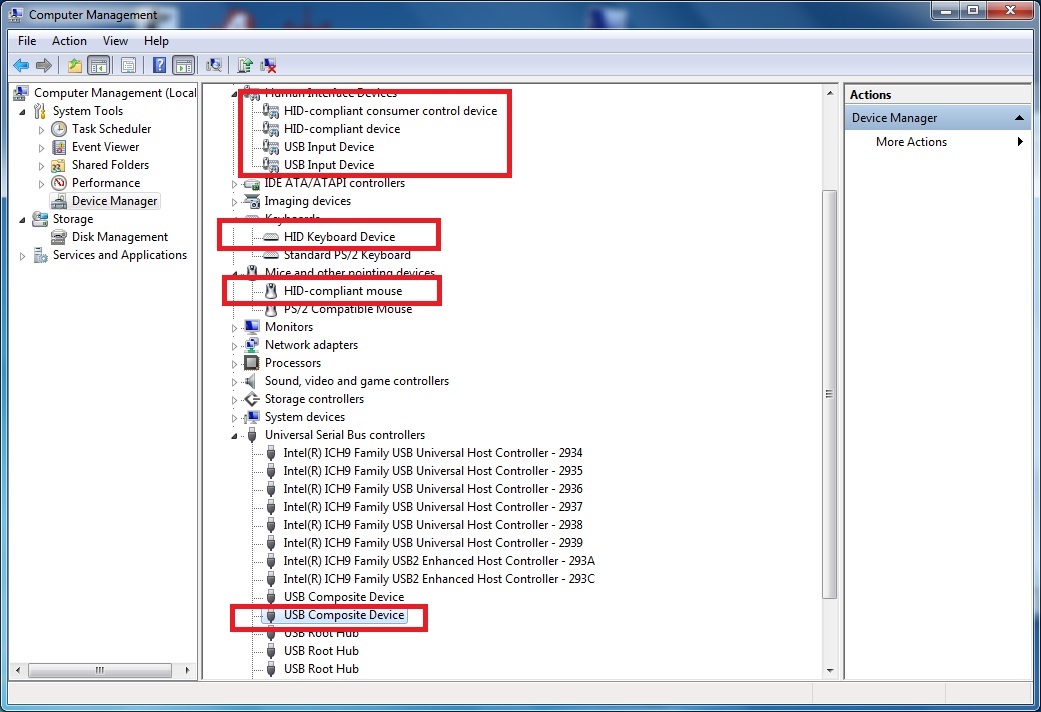

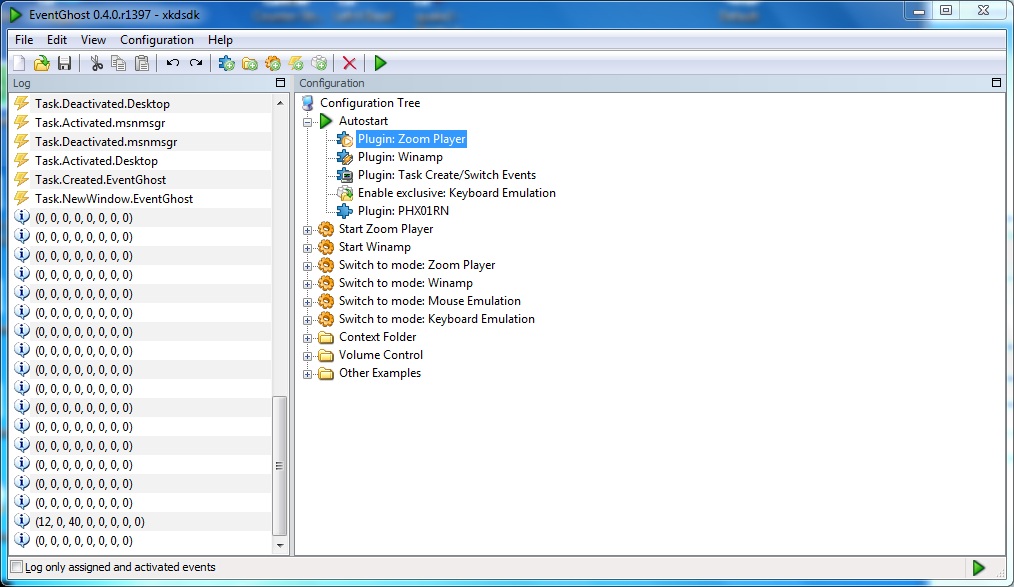

Se attached files for Remote picture and Devicemanager tree (before installing PHX01RN driver via eventghost). And eventghost configuration.
To my problem.
It seems like Eventghost registrers all the buttons I push, but I can't assign them.
And it seems like it registrers same code for volume down as for volume up.
Allt he 0,0,0 etc are volume up and volume down signals and the last row is when I press Media Center Button. But these comes up as an "informational" in the log and I can't drag and drop them to assign them to a task (look at attached image).
I know this isn't the PHX-01RN remote but it looks like it behaves the same way as it registrers all the remote pushes.
(0, 0, 0, 0, 0, 0, 0, 0)
(12, 0, 40, 0, 0, 0, 0, 0)I know this isn't the PHX-01RN remote but it looks like it behaves the same way as it registrers all the remote pushes.
