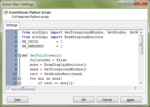

I found a solution:
Python Script:
from win32gui import GetForegroundWindow, GetWindow, GetWindowRect
from win32api import EnumDisplayMonitors
GW_CHILD         = 5
GW_HWNDNEXT      = 2
def GetFullScreen():
    fullscreen = False
    mons = EnumDisplayMonitors()
    hwnd = GetForegroundWindow()
    rect = GetWindowRect(hwnd)
    for mon in mons:
        if rect == mon[2]:
            fullscreen = True
            break
    if not fullscreen: # maybe some child ?
        child = GetWindow(hwnd, GW_CHILD)
        while child > 0:
            childRect = GetWindowRect(child)
            for mon in mons:
                if childRect == mon[2]:
                    fullscreen = True
                    break
            if fullscreen:
                break
            child = GetWindow(child, GW_HWNDNEXT)
    return fullscreen
eg.result = GetFullScreen()
But I do not know if it will be reliable in practice and whether it will work in all cases that you need.

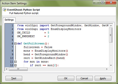

I'm a novice, can you explain to me how to create the script? I create a *.txt file with the lines you give us and I save it to *.py?
This is this?
Re: WindowState? If fullscreen do A. If not do B.
FCB38 wrote:I'm a novice, can you explain to me how to create the script? I create a *.txt file with the lines you give us and I save it to *.py?
This is this?

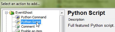

No, you need no *. py file.
You simply add to your configuration the action Python Script.
Once you put the action, opens a simple text editor.
There you paste (or write) a script and confirm OK.
