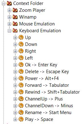

Thanks for the reply. After hunting around through a lot of _init_.py files, I thought I'd found this issue, but it seems not. When you install the Keyboard plugin, in your working *.xml file under the " <Folder Name="Keyboard Emulation" id="348">", a number of entries for the arrow keys are inserted such as:
<Macro Name="Up">
<Event Name="Up" />
Window.SendKeys(u'{Up}')
EventGhost.AutoRepeat(0.59999999999999998, 0.29999999999999999, 0.01, 3.0)
But I can't figure out what is generating this. The keyboard plugin itself appears to only call SetKeyboardCallback. From there, I can't track it down.
So, I tried deleting the AutoRepeat action from my *.xml. Strangely, the "Autorepeat current macro: 0.6" no longer occurs, but I still get double entries when using those keys.
Isn't this happening for others? When you click on an entry in the configuration pane of EG or even on an entry in a list of files in Windows Explorer and press the Up or Down key, do you move one line or two? I could never figure out why when I was editing text, my cursor would move back two spaces with the left key, until this problem came to light.

FOUND IT! In the default *.xml file that comes with the EG installation is a "Context Folder" with a subfolder of "Keyboard Emulation". When I disabled that subfolder, the double entries stopped. Jonib, thanks for weighing in.

Disable or delete the Keyboard Emulation folder in the Context Folder.

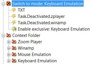

That might not be enough, because from memory the mode switching folder will re-enable the keyboard folder automatically when another program quits. You might need to disable the mode switching folder if it's there too.
Blaher, you make a very good point. If the Switch to mode: Keyboard Emulation macro gets triggered, it will re-enable the Keyboard Emulation folder. So, you're absolutely right, the Switch to mode: Keyboard Emulation macro also needs to be disabled just to be sure (or just delete, rather than disable, the Keyboard Emulation folder).
