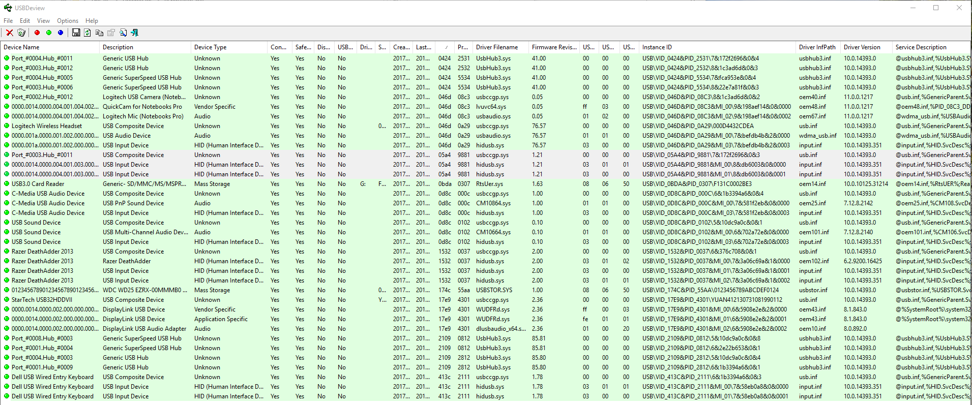

Regarding how to get the EG driver installation dialog to pop, you don't need to reinstall the plugin. Simply disable / enable it is sufficient. However, the dialog only pops if all three USB devices are present (Composite + 2 HID input devices).
So I brought up the EG driver dialog first, and then tried various combinations of uninstalling the three usb devices before installing the EG driver. In the end, the driver installation just fails the same way.
I attached a screen shot of the USB devices and default drivers.
So, I have no clue what to do next. I'd buy you one of these remotes if it would help you debug it.
Cheers :)

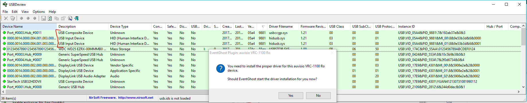

Then I used the big stick on the USB stack. Wasn't that hard at all. Mouse was plugged directly into computer, so I saved mouse to last and uninstalled all devices, then all composite devices, then most hubs, and last the mouse and one remaining hub at least attempted. By then the computer wasn't usable anymore, the mouse was uninstalled, but two hub ports were not by the time I shut the computer down. Can't tell if it matters or not.
Unfortunately it didn't help the Auvisio USB issue. EG suggested install drivers, which failed just as before. I ran usbdeview and posted a screen clip after reboot.

Something has changed now though, because when I uninstall the device in USBDeview, they immediately (<3s) reinstall using the bad driver. Before they would only reinstall when reinserting the device.
Hmm. I'm leaning towards attempting to uninstall the KB3211320 update and see what happens.
