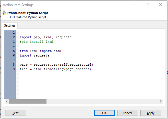

I don't follow; what actions were taken to change the status of this thread to SOLVED? I'm getting the same error in my Python Script actions. Specifically, I'd like to use lxml.

I've installed the version of Python you referenced but unable to get EventGhost to overcome, "ImportError: No module named pip"
Appreciate any direction on what I'm doing wrong here, thank you gents.

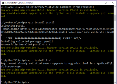

Thank you for your input; I'm certain I'm missing something small but important still...
Installed blackwind's suggested/linked Python 2.7, ran
C:\Python27\Tools\Scripts\win_add2path.py,
then your suggestion and my target module with this output from the command line:
Looks good to me, correct?

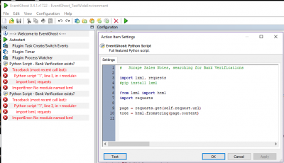

Unfortunately, two EventGhost restarts later, I still receive in EventGhost's log:
ImportError: No module named lxml
Thought pip being out of date, in some crazy unforeseen manner, *might* have something to do with it so I updated that, rechecked psutil and lxml using "python -m pip install --upgrade psutil" and restarted EventGhost again to find, "Requirement already up-to-date [...]" and the same ImportError when testing my script to import lxml.
I'll keep digging; it's gotta be something simple!
Edit: In fact, just replaced lxml with pip: same result. poo
Re: [SOLVED] ImportError: No module named win32_ctrls
OK you problem is simple...
Upgrade to EG 0.5
this feature is not available in 0.4.x

High five!!
Uninstalled EventGhost 0.4 Stable,
Installed EventGhost 0.5 RC6
Works -- Thank you so much!
