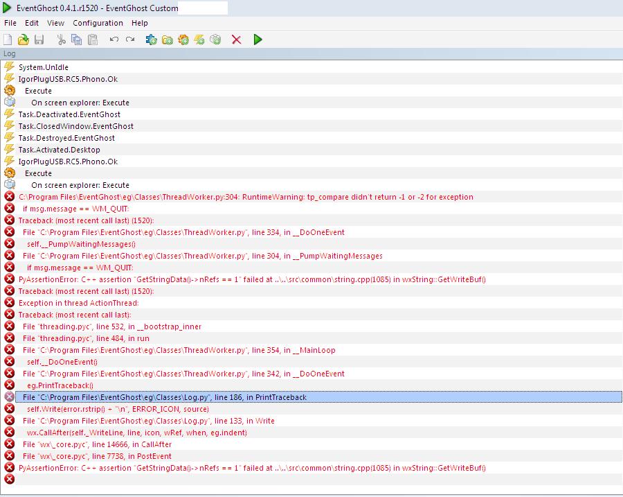

Hello this occured when i was using winamp.
How it happened..
1) OSM -> Selected The m3u from list (playlist for mp3 winamp)
2) After selecting Winamp Opens with the playlist. But goes out of focus so i added find window which works
3) After some time it gives the error (if u have a gap or break).
Problem : Unstable, Non Responsive, Hangs, Exit
See the attached file for error

I guess the problem is with find window or XBMC2 that is the only thing i edited in the xml.
C:\Program Files\EventGhost\eg\Classes\ThreadWorker.py:319: RuntimeWarning: tp_compare didn't return -1 or -2 for exception
Traceback (most recent call last) (1520):
  File "C:\Program Files\EventGhost\eg\Classes\ThreadWorker.py", line 319, in __DoOneEvent
    if resultCode == WAIT_OBJECT_0:
  File "warnings.pyc", line 29, in _show_warning
  File "C:\Program Files\EventGhost\eg\Classes\Log.py", line 75, in write
    log.Write(data, ERROR_ICON)
  File "C:\Program Files\EventGhost\eg\Classes\Log.py", line 133, in Write
    wx.CallAfter(self._WriteLine, line, icon, wRef, when, eg.indent)
  File "wx\_core.pyc", line 14666, in CallAfter
  File "wx\_core.pyc", line 7738, in PostEvent
PyAssertionError: C++ assertion "GetStringData()->nRefs == 1" failed at ..\..\src\common\string.cpp(1085) in wxString::GetWriteBuf()

I'm getting this error as recently as r1582, and it appears to be triggered randomly without any rhyme or reason:
Traceback (most recent call last) (1582):
  File "C:\Program Files (x86)\EventGhost\eg\Classes\ThreadWorker.py", line 319, in __DoOneEvent
Exception in thread ActionThread:
  File "C:\Program Files (x86)\EventGhost\eg\Classes\ThreadWorker.py", line 354, in __MainLoop
    self.__DoOneEvent()
  File "C:\Program Files (x86)\EventGhost\eg\Classes\ThreadWorker.py", line 342, in __DoOneEvent
    eg.PrintTraceback()
  File "C:\Program Files (x86)\EventGhost\eg\Classes\Log.py", line 186, in PrintTraceback
    self.Write(error.rstrip() + "\n", ERROR_ICON, source)
  File "C:\Program Files (x86)\EventGhost\eg\Classes\Log.py", line 133, in Write
When it occurs, EventGhost no longer responds to my hotkey sequences until I restart the program. It doesn't occur as a result of using one of my sequences -- just randomly, out of the blue -- so I'm unable to trace it back to anything in particular. I only use Keyboard events currently, so no "TaskActivated", "System", or similar triggers could be setting it off.
Thoughts? Anything you'd like me to try to get a better idea of what's going on?
/bw
blackwind
Posts: 182
Location: Canada
Re: Problem in Ver r1520
Post by blackwind »
For what it's worth, I haven't seen this since I upgraded from SetPoint 6.32 to 6.50. It's possible that's the solution.
