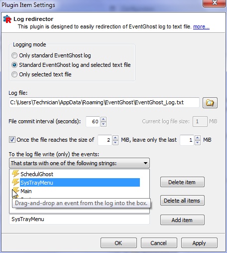

I have in one PC installed EventGhost as a "service".
It's not obviously a really service, but EventGhost is started before user logon.
This is done using the Windows Scheduler (option When my computer starts (before a user logs on).
The problem is that in this case is not available EventGhost window and therefore the log.
That's why I made this plugin that allows you to save the log to a text file.
I think this plugin can be used in other situations too.
I made only very short tests, and so I do not know how the plugin will behave after prolonged use.
EDIT 2015-03-17: added new version 0.1.0
Plugin Log redirector and filter - version 0.1.0
- event filtering can be used even for native EventGhost log
- added identifiers INFO, NOTICE and ERROR
- filter string can contain curly brace wildcards {*} and {?}
(31.92 KiB) Downloaded 523 times

Re: Log redirector
I was some time away from the internet and in the meantime I made some improvements to the plugin.
1) Version 0.0.1
This version has added feature of monitoring the size of the log file.
You can choose the maximum size (max 999 MiB). Once it reached the selected size of the file, file is truncated (of course the latest entries are kept).
The size of the truncated file it is also possible to choose.
Version 0.0.1
(14.74 KiB) Downloaded 590 times
2) Version 0.0.2
This version has added the possibility of filtering events. I do not think that this option will be used by many people.
But because it was not difficult to implement this feature, so I did.
There was also changed the unit of file commit interval. Now that figure is in seconds. So be careful when upgrading from version 0.0.0!
Version 0.0.2
(26.86 KiB) Downloaded 605 times

I tried installing the Log Redirector plugin (v.6). I can bring up the config page but I amunable to adjust any of the settings. Any thoughts on what I could try.
Take Care
Re: Log redirector
ijourneaux wrote:I can bring up the config page but I amunable to adjust any of the settings. Any thoughts on what I could try.
Maybe there is some error in the plugin, but more likely is that you are doing something incorrectly.
But how can I know what? Maybe a screenshot would help.
ijourneaux
Posts: 102
Joined: Wed Feb 17, 2010 2:20 am
Re: Log redirector
Post by ijourneaux »
Sorry Pako. I really didn't give you much to work with. I did figure it out though. At first I didn't understand the logging mode options. I thought the Log EventGhost only meant log eventghost evetns to log file and couldn't figure out why I couldn't specify a file.
Now that I correctly read the options correctly it is clear what you meant
option 1 log eventghost events to eventghost window
option 2 log eventghost events to eventghost window and log file
option 3 log eventghost events to log file
