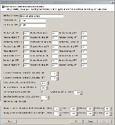

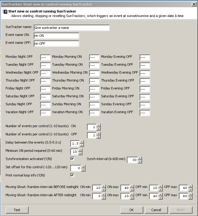

3) Make some screen shots of the current SunTracker actions (the settings view like the one above)
4) Print them if you need
5) Delete your already created SunTracker actions
6) Create the actions again with the same names as before and with the same event names (important)
7) Re-enter your other settings
Save, restart EG with this project and it should run as earlier
When you decide to activate "Moving Ghost", open settings for the action, check the check box, click OK. Then click "Save" to save the project. Restart EG and it will run "Moving Ghost" function for that action.

- Individual settings for bursts (ON/OFF) added
Hope the setting screen will fit your PC screen. I have something like 1280x800 and its OK for me but with lower resolution it might go outside your desktop area...don't know how to fix it...
PS you will have to delete and recreate your actions if you have the previous version running already
24.09.2008_SunTracker.zip
(62.98 KiB) Downloaded 777 times

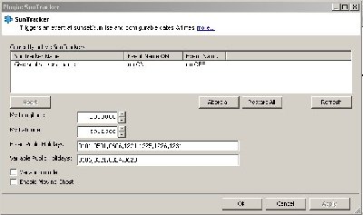

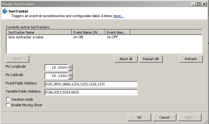

I have made some modifications to this plugin
After using it for a while I become a bit irritated in the behaviour when I needed to make modifications to the settings
What I wanted to achieve was that whenever a setting is changed, the necessary part shall read this new data and use it. Basically for this to happen, a full or partial restart was necessary
Besides, I thought some of the settings should be "common" while others still should be "individual"
Therefore I have moved the following variables from the action settings to the plugin settings;
-The geographic position (longitude & latitude)
-Fixed and Variable Public Holidays
-Vacation mode
-Moving Ghost mode
I have also changed the behaviour of some buttons...
If you click "Restart All" all defined actions will restart independently if they are running or not
If you make a change of the setting in the plug-in, all defined actions will also restart when you click "OK"
If you make a change of an action setting and/or you click the "OK" button, the action will restart
All was made with an effort to make it easier to use when changing any settings. Now the affected parts are automatically restarted if needed
If you migrate from previous version, you will unfortunately have to make the configuration again, there is no way I can figure out how to migrate the data. You will have to delete the actions as well as the plugin and start all over again :(

I have tried SunTracker m. Movin Ghost, and i wonder:
There is 2 off-settings, but only 1 on-setting?
You can set "Night Off", "Morning On" and "Evening Off", why not "Afternoon On"?
What i wan't is to put the lights in my windows on at for example 15.00, but the latest time i can set in "Morning On" is 11:59.
How can i get the light on at 15:00?, why is it a limit at 11:59?
Would't it be simpler if you had for example 3 on and 3 off -times per day?
Regards Glunka
Re: SunTracker plugin - with moving ghost
When I created the SunTracker plugin, I had my outdoor and indoor lamps of my house in mind. I tried to cover all needs but it might be I missed some use cases...
To explain the idea behind, it is best is to start with the morning of a new day and assume that you have not modified the offset settings:
The SunTracker can then turn ON something like lamps at a defined time like 06.00
At sunrise the lamps will go OFF
Then nothing really happens before sunset later in the afternoon or evening depending on the season
At sunset, the lamps are turned ON
Then you can define a time when the lamps shall be turned OFF again, either later in the evening like 23.00 or during the following night like 02.00
Now you are waiting for the next morning action of the new day to happen and it all starts from the beginning
If you need to turn on and off devices at certain fixed times, you can use the Scheduler I made for such purposes. There you have more settings for fixed on/off actions
http://www.eventghost.org/forum/viewtop ... f=10&t=818
My idea was never to combine the Scheduler with the SunTracker, I wanted them to be separated. Its so easy anyway with EG to add the two plugins.
I hope this explained better, but if you still believe there should be a change made to the SunTracker it is not impossible to do. But as I said, I did not and I do not target to bring the two together into one.
