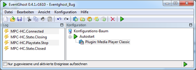

liggers wrote:I stumbled upon a problem just after upgrading from EventGhost_0.4.1.r1572. The problem started appearing in r1580.
If i activate the Media Player Classic Plugin and i open a video file with MPC, an additional empty MPC window is opened.
1. Can you please write the exact steps that leads to the described behavior?
2. Can you please try the latest beta MPC-HC (1.6.6.6723 now) ?
The exact steps are:
1. Start Eventghost with Plugin "Media Player Classic" enabled
2. Navigate to a video file in Windows Explorer and start/open it with MPC-HC (Doubleclick or Enter)
3. See described behaviour (a second, empty MPC-HC window pops up)
This second window catches, as far as i can tell, all commands issued from Eventghost. That means the playing window receives no commands, even if i close the empty one.
This is the example configuration used:
This also shows the Events after starting and closing the video / MPC-HC.
If you disable the plugin and redo step 2, everything is fine. Except that you are not able to control MPC-HC with Eventghost :wink:
Edit: No improvement with latest MPC-HC beta.

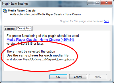

+1:
I have the same problem with MPC-HC.1.6.5.6366.x86 and EventGhost_0.4.1.r1610 and mpchc plugin 2.5.
EDIT:
I found the problem:
As mentionned in plugin settings:
I checked my mpchc settings and it wasn't the good setting,..., this is the good one:
But i always have the ID keys problem.
Some of them are: "Menu DVD", "Up,down,left,right DVD" ..etc..
My test were wrong because i had the window problem.
Now it seems to work fine too :)

Pako wrote:That's interesting. I tried, as you describe it, but nothing bad happened.
But then I tried the same way to open a file located on a network drive. And voila - now the problem appeared!
I found that the problem lies in the fact that EventGhost is trying to connect with MPC-HC when MPC-HC is in a "Not responding".
So I had to add a loop in which the above condition is tested. EventGhost will try to connection only at the point when MPC-HC is responsible.
You can download the corrected plugin from the SVN repository.
It is possible that the some problem will reappear, but it should be much better. During my testing, everything was fine.
The revision 1616 doesn't fix the problem, it just delayed the opening of the second MPC window.
But i use the option in MPC that says "Open a new player for each media file played".
I suppose i have to stick to plugin revision 1560 if the new plugin can't support this option in MPC.
liggers
Re: Media Player Classic
liggers wrote:The revision 1616 doesn't fix the problem, it just delayed the opening of the second MPC window.
Yes, in this case, you have bad luck and you have to use plugins version 1.x.
The last version was 1.7, which was included in EventGhost r1572. For plugins version 2.0 and later, this rule applies:
The way back is not possible. Version 2.x have much more options. Some functions (which are now included in the plugin) would not have been possible before.
