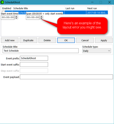

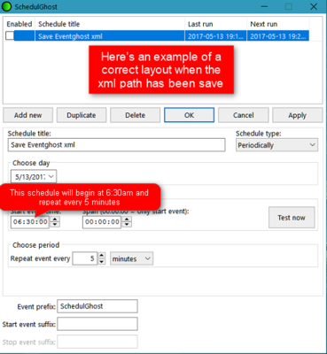

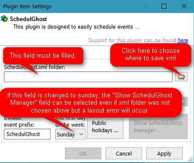

I was also experiencing the issue of the erroneous layout in SchedulGhost so I decided to test a few scenarios to determine if the issue was one that could be easily fixed and this seems to be the case on my machine at least. I hope that this easy solution might help others. I've tried to include a few illustrations of the issue as well.
In summary, it appears that an xml path and possibly a log file path must be saved in the plugin in order for the layout to function correctly. It also appears that the plugin must be deleted and re-added in Eventghost 0.5rc in order for the issue to be resolved and the issue seems to be exclusive to 0.5rc since I have never observed this behavior in the previous version of Eventghost. The plugin also seems to work fine when it is deleted and readded after restarting Eventghost forcibly by selecting exit. The problem persisted when the restart option found in the file menu was used. The issue also persisted when the "restart as administrator" option was used from the file menu.
