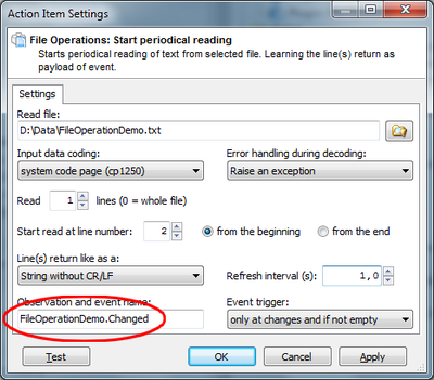

I am searching for something that allow me to read a line in a text and create an event when a specific word is there. This plug in allow this?
Re: File Operations
Of course, it's very simple:

First off, I have to admit that I am a complete EG newbie and struggling big time with its steep learning curve.
I am trying to periodically read out certain lines of a file and broadcast the result.
I have been progressing in baby steps:
* I got the part working which extracts the data I want - from both, a periodically and one-time read out
* I can print the result of the one-time read out (=> print eg.result). I was thinking of using the print command for the time being till I get the File module properly working, i.e. before I 'graduate' to the Broadcasting part.
Here is where I got stuck:
*I cannot print the result of a periodical readout.
*I cannot get the broadcasting part working for either, periodically or one-time. I am not clear what to put in under 'Observations and event name' in the File Operations module, not under 'Command' and 'Payload' in the Broadcaster module.
I have been searching here and the web for documentation, but thus far found only rather limited information.
Any advise would be greatly appreciated.
Re: File Operations
When you use the action "Start periodical reading", so you can not print eg.result. This action does not result, this action only starts the periodic reading.
Content (or certain lines) of file you can only receive as eg.event.payload.
You certainly do not need to actually print the "result".
Perhaps it would be better to write exactly what you need.
