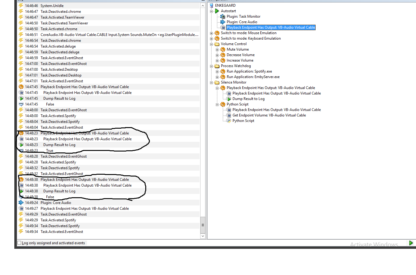

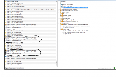

I remoting my eventghost host using teamview, which does not have the same audio implications as RDP does.
I am also using vbcable drivers as a virtual soundcard.
https://www.vb-audio.com/Cable/
The PC is used in combination with tuneblade airfoil etc.
no events are received when starting stopping playback in spotify on the EG machine.
when I test the action I get:
Is Playback Endpoint Active: VB-Audio Virtual Cable
I have a custom created console app. written in c# that works ok. But I would like to have it working in EG.
Here it is for reference. it uses win32 api calls.
Essentially what it does is starting tuneblade when audio is active for 3 sec. and killing tuneblade once audio has been silent for X seconds.

I get this in the log window:
14:48:23 Playback Endpoint Has Output: VB-Audio Virtual Cable
14:48:23 Dump Result to Log
14:48:23 True
14:48:28 Task.Deactivated.EventGhost
14:48:28 Task.Activated.Spotify
14:48:32 Task.Deactivated.Spotify
14:48:32 Task.Activated.EventGhost
14:48:38 Playback Endpoint Has Output: VB-Audio Virtual Cable
14:48:38 Dump Result to Log
14:48:38 False
so the result is true when audio is active and false when inactive.
So it works :)
although no events are thrown :(
