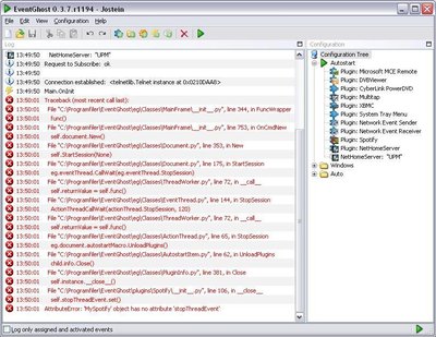

Re: Plugin for Spotify
Hi krambriw.
I have been a long time user of spotify, so when i found that you created a plugin for it i desided to use it instead of emulating keystrokes.
I think i have found some sort of bug.
I desided to disable it when the activety spotify isent activated due to the log messages "Spotify Window was not found". As i close down spotify completly when doing other things. The problem is if load the EG config file whit the plugin disabled i get a fault if i try to create a new config file or try to open an exsiting one.
Also any plans of making a shutdown comand for spotify. (I like to close it down completly if i start an other activity like for example Power dvd. becouse of the fact: if i play a song with spotify and start power dvd i have to make a play/pause to spotify first, this is weary unstable due to the fact that i might not be playing a song at the moment and then the song starts when power dvd opens.) A other option would be to make two new comands stop and play to the plugin seperate. This i think could be acheved with monitoring the "Get current Status" before executing play and stop becouse every time it is stoped it shows: Spotify running! Not playing anything...
None of these points are urgent and i dont need any of theme as i have built my own sulution disabling and enabling the plugin. But it is a sugjestion if you plan on further develop the plugin.
Anyway other than that i am veary satesfied with the plugin, thanks.
Best regards Jostein

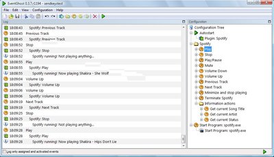

First of all, I think the bug described by Jostein should be fixed
Attached is a new version that also implements some new actions
- Stop
- Play
- Minimize and stop playing
- Terminate Spotify
To upgrade: replace the file __init__.py
I think its easiest to make a new configuration but you can try with the current first. Maybe you will miss some actions but they can be added manually
As you can see in the picture, I have also made a macro to start Spotify if needed. If you need this, you will have to create it manually but it is very simple to do
- Stop
- Play
- Terminate Spotify
