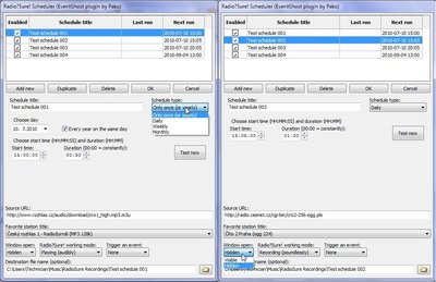

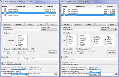

Still, I worked on it and from this moment is part of the plugin also comfortable Scheduler.
New version of plugin is available for download only (hopefully temporarily) from the SVN repository.
Before starting work I was thinking that maybe Scheduler will use people who do not know EventGhost and will not be using any other functions EventGhost.
Therefore, the Scheduler behaves (with a few exceptions) so that it looks like a completely separate application.
On the other hand, it is also possible through integration into EventGhost remotely (from another computer) to disable, enable, delete, edit and even add the schedule!
Scheduler configuration is saved to a file Scheduler.xml. This file, users can also exchange between themselves.
Currently you can choose from four different types of schedules. If interested, I can add even more.
Because for me it is a big problem to write in English, will follow only pictures.
Please review it carefully and I think that everything important can be found in them.

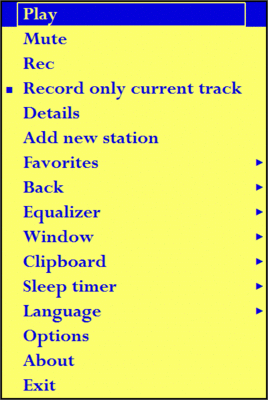

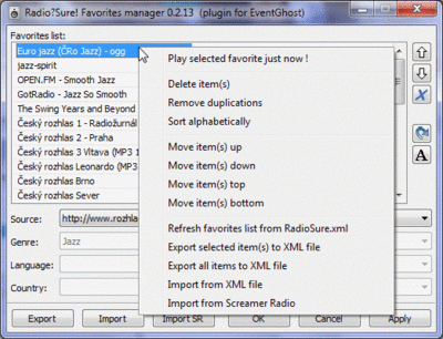

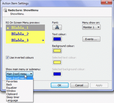

I have conducted an extensive upgrade plugin RadioSure.
The most noticeable improvements are two:
1. Favorites Manager (has more features than the Import and Export. Also import from Screamer Radio !)
2. Menu browser (using the remote control you can either browse the whole menu of RS or you can jump directly to any of the submenu)
