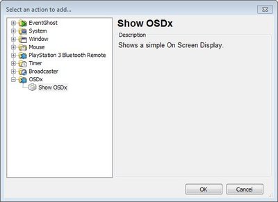

Hi guys,
This plugin is a simple modification of the built-in OSD plugin. It works pretty much like the original, except you can now display multiple OSDs simultaneously. To avoid overlapping texts though, when an OSD with the same monitor & alignment pair is already being shown, the new one will just overwrite the old.
I don't use Python very often... Please feel free to correct/modify/improve what I did.
OSDx-001.zip
(6.38 KiB) Downloaded 262 times

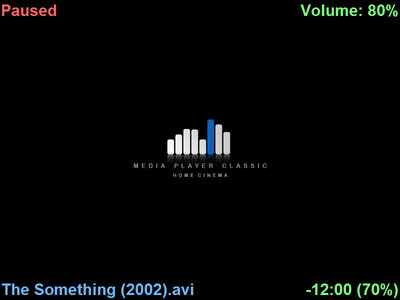

Example:
<EventGhost Version="1610">
    <Macro Name="Test" Expanded="True">
            OSDx.ShowOSDx(u'Volume: 80%', u'0;-32;0;0;0;700;0;0;0;0;3;2;1;34;Arial', (128, 255, 128), (0, 0, 0), 1, (0, 0), 1, 10.0, False)
            OSDx.ShowOSDx(u'-12:00 (70%)', u'0;-32;0;0;0;700;0;0;0;0;3;2;1;34;Arial', (128, 255, 128), (0, 0, 0), 3, (0, 0), 1, 10.0, False)
            OSDx.ShowOSDx(u'The Something (2002).avi', u'0;-32;0;0;0;700;0;0;0;0;3;2;1;34;Arial', (111, 183, 255), (0, 0, 0), 2, (0, 0), 1, 10.0, False)
            OSDx.ShowOSDx(u'Paused', u'0;-32;0;0;0;700;0;0;0;0;3;2;1;34;Arial', (255, 102, 102), (0, 0, 0), 4, (0, 0), 1, 10.0, False)

Thanks for this plugin :) I've just tried it (almost 3 years later after its availability :p ), It works well but I have an issue with MPC, I can't get the OSD to display when I open MPC in fullscreen mode, It works well only when it's "Windowed". I can see in your screenshot that you are in fullscreen mode and that you're able to display some texts with the OSD, how did you do that ? Does it still work for you ?
I'm using the latest version of EG (0.4.1 r1722) and MPC-HC (1.7.10).
