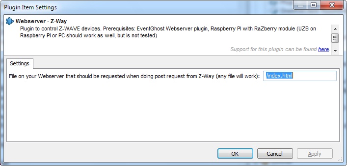

The parameter on the plugin specifies the file that is requested on your EG webserver with post requests that come from the razberry plugin. (it has to request something)
This can be any file, but the smaler the better.
"/empty" may not exist in your webserver, if you remove the entry and leave it blank it will request the index, which should always work.
So if you are unsure, just write nothing in that box. (and remove what's in)
In my config I use a file called "empty" which is an empty file, I may have set this as default parameter, but intantionaly I wanted to leave it blank.

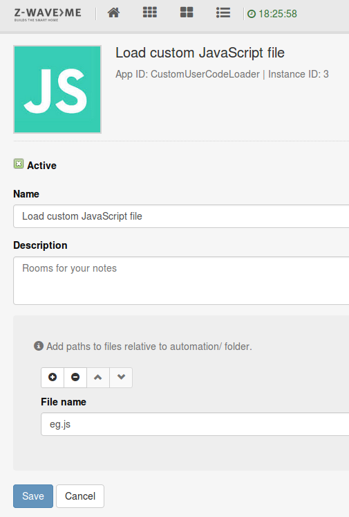

Hello Phil,
you're right, mine changed as well... (strange, last time I looked it was different)
Here is a screenshot!

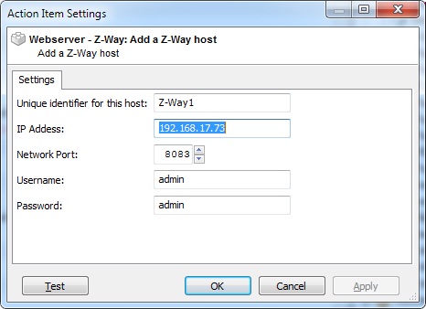

Hi Gus, which version of z-way are you using?
Can you send me some screenshots how you configured the add host action in eventghost and the js script on z-way side?
Thank you!
Thank you!

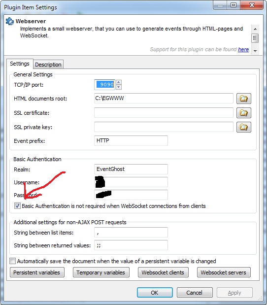

I think I solved it!
I was fault trace with tcpdump on the RPI, and I saw that there was no incomming traffic.
So, back to EG, under Plugin Webserver, this settings needed to be checked:
12:15:34 Z-Way.Debug.Z-Way1 u"connected!"
12:15:34 Z-Way.Z-Way1 [u'SwitchMultilevel', [u'20', u'0', u'38'], 0, u'%']
Yey!!
Yey!!
