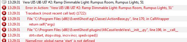

The 'set light level' works well, but the event that is generated sometimes seems to be an unrelated scene, eg. wrong room, and scene, but the level is reported correctly.
The 'level of a dimmer' doesn't seem to generate an event, if that's its purpose.
And the 'ramp dimmable light' gives me a 'start' variable error.

Re: MiCasaVerde Vera UI5, UI6, UI7 Plugin
eg.result baby
LOL
it returns the current dimmer value.
i did that so if you are going to use the ramp feature you have a known stating point and can go up or down from there so the lights don't be hittin ya with a light show because it's at say 15% and your script told it to start at like 40%.
the light would skyrocket to 40 then slow down to the speed you had set.
so i thought it would be usefule to just have a function that return the current dimmer value so that won't happen
yeah I know there are going to be some glitches and i caught that one with the device instead of the scene label.
it's because of how i combined all the egconfig panels together in common code.
it's the only one that doesn't use a device
LOL
so when i iterate through it it grabbed it as a device, tho the data is correct in the field.

doah! i forgot to change the var names on the ramp, that's a 30 second fix. but i will release the latest when i am done with the vacation timer and i will have that fixed as well as the device thing in the scenes.

I changed the Vera pluginbase class name to VeraK, ( after the artist :) ), from Vera, and voila, no more clash with the old plugin, i.e. neither are renamed to #2.
The ramp feature works well now too. It would be a cool feature to be able to abort the sequence, eg. if it's gradually dimming, and someone decides they need a brighter light, they don't have to fight against the rampable sequence.
