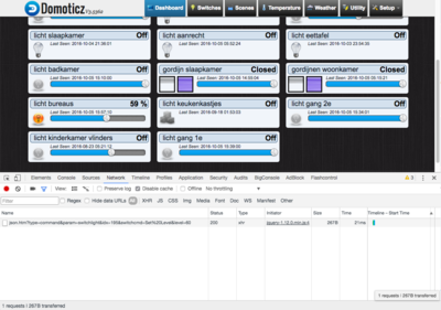

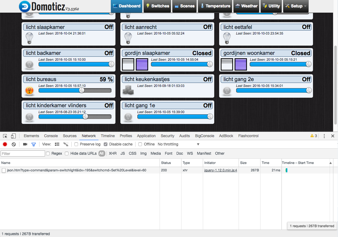

To check what Domoticz uses internally you can use the developer tools in your browser. For example, in Chrome it looks like the attached screenshot. As you can see, it's the same command so if it works from your browser it should work from the plugin as well.
Note that the value is always off-by-one since it starts counting at 1 instead of 0. So 60%=61 and 100%=101

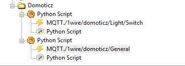

So I made a first testing version following the json structure you provided. It has a dependency that the word 'domoticz' must be found in the msg.topic in messages from domoticz
(35.12 KiB) Downloaded 287 times
Typically you will receive the following events for Domoticz where now only the values are kept
09:17:08   MQTT./1wire/domoticz/Light/Switch [255, 12, 'Light/Switch', '00001201', 195, 'licht bureaus', 2, 'Switch', '68', 'Dimmer', 1]
09:17:08   MQTT./1wire/domoticz/General [255, 12, 'General', '00000701', 78, 'kWh pc media', 0, 'kWh', '226.200', '654594.750', 1]
Based on this you could create a macro structure and extract whatever values from the list in the payload using simple python scripts
If you think we need a more specific event suffix to be able to directly trigger individual actions on state changes without using python scripts it can easily be made. Like for instance
MQTT./1wire/domoticz/Light/Switch/On/Off/57/0
and
MQTT./1wire/domoticz/Light/Switch/On/Off/57/1
