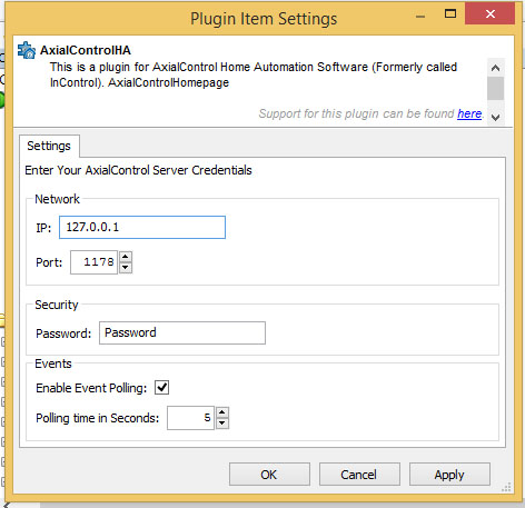

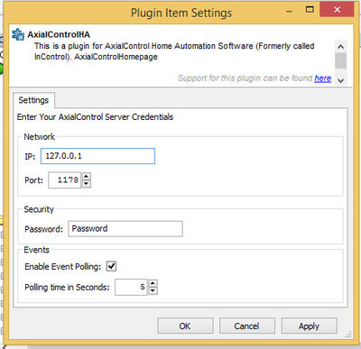

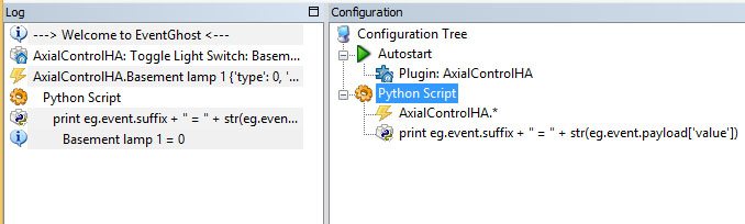

Added Event Generation, Calling it v1.0. I plan on switching things over to a websocket connection when i can figure out the commands. But for the time being it's setup with a polling thread. This is optional and the polling time is configurable. It will generate event's in this format. "AxialControlHA.deviceName({'type': xxx, 'deviceID': 'xxx', 'value': 'xxx'}). I'm open to suggestion on the formatting of this but if you want to get the value for the event it can be parsed out like this:
deviceName:
deviceValue:
deviceType:
deviceID:
Or you can do something like this in the screenshot(copy/paste this into your eg.tree):
deviceName:
eg.event.suffixCode: Select all
eg.event.payload['value']Code: Select all
eg.event.payload['type']Code: Select all
eg.event.payload['deviceID']Code: Select all
<EventGhost Version="1722">
<Macro Name="Python Script" Expanded="True">
<Event Name="AxialControlHA.*" />
EventGhost.PythonCommand(u'print eg.event.suffix + " = " + str(eg.event.payload[\'value\'])')

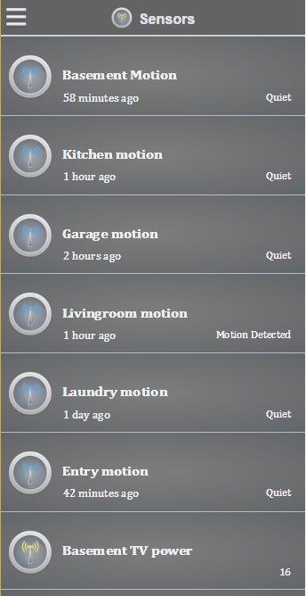

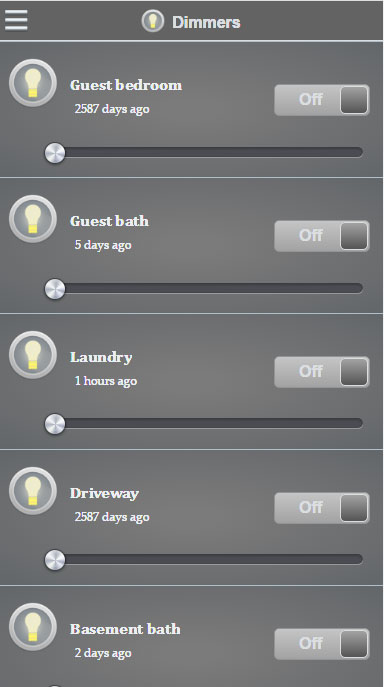

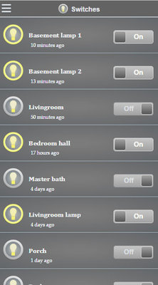

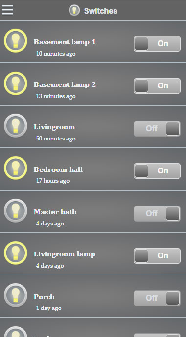

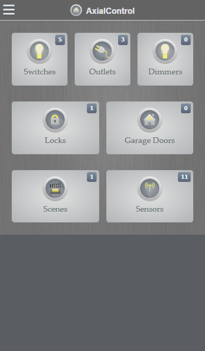

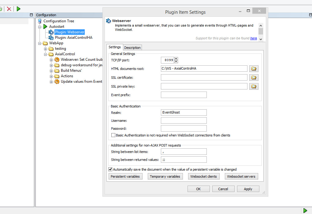

This is a simple web app that uses this plugin and the webserver plugin. It still has a few small bugs to fix but is in pretty good working order if anyone feels like playing around with it. There are a few screenshots attached at the bottom of this post.
Step 1:
You will need version 1.0 or higher installed of the AxialControlHA plugin.
Step 2:
Open the attached eventghost tree.
Step 3:
Configure the AxialControl plugin with your server credentials. Also enable Event polling, i usually set my polling time to 5 seconds. Step 4: Configure the Webserver plugin to point to the supplied html folder. Also set your prefferred port to run the webserver off of. (Note: if you experience any errors with the webserver plugin. Update to the newest version here: viewtopic.php?f=9&t=1663) Step 5: Load the webpage in your prefferred web browser(Your PC's ip that runs EG and the port set in the webserver plugin. Example: 127.0.0.1:8099). You can run this in fullscreen on chrome by saving the link to desktop and choosing open in window.
