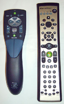

Now I'd like to ask some questions about my specific setup. I have two Gyration Media Center RF remote controls, I don't see a model number on either one so I'll try to attach photos. I don't have the software that came with them or Windows Media Center for that matter so most of the functions I can't use. But they do both operate as a mouse, they are easy to use and it's very handy when doing media applications and other things at the same time, or having to navigate media errors and functions that normal remotes won't do.
So obviously what I would like to do is assign functions to the unused buttons just as if they were IR remotes. The problem as a said before is only the buttons that I can already use are being logged as events. EG isn't seeing the others.
Some of the plugins, HID, Bluetooth, see 10 Gyration receivers attached to my computer although I only have 2. I've gone through all of them and only one picks up any more buttons and that's only a couple from one of the remotes. Can anyone explain either of these things?
I'm guessing the issue is I don't have a plugin capable of detecting the other buttons. Is there an RF plugin that might work? Is this a feasible use of EG or am I wasting my time?

I've toyed with all the other plug ins so I have a better idea of what they do and hopefully keep me from asking obvious questions again.

Hi level20peon, thanks for your reply. I finally got back to this project a couple of days ago and your post got me going nicely thank you. Couple of differences between my results and yours though.level20peon wrote:@specter333: Just ask if you have questions left with the Gyration Remote. I tried to write the HowTo as clearly as possible in the MediaPortal Forum but maybe I missed something.
The ÔÇ£Live TVÔÇØ, ÔÇ£GuideÔÇØ and ÔÇ£MoreÔÇØ buttons are mappable one mine.
And down at the bottom, the ÔÇ£SetupÔÇØ and ÔÇ£InputÔÇØ buttons are mappable but the ÔÇ£ConnectÔÇØ button is not.
Also, in the number pad the ÔÇ£StarÔÇØ and ÔÇ£PoundÔÇØ buttons are not.
By the way, those are all mappable with the USB-UIRT, not through the RF receiver.
With the smaller remote in my pictures I finally realized that it is being recognized as a generic HID device and not one of the Gyration devices. All the buttons on top, that arenÔÇÖt recognized by windows already, as well as the two unnamed buttons on the right side are mappable. I havenÔÇÖt tried the two buttons on the left side since that would mess up my connection with the receiver but I would bet they are mappable too.
IÔÇÖm running XP Pro service pack 1 and the USB-UIRT as well as two different Gyration RF receiver, one for the Media Center Remote and keyboard and one for the other remote, keyboard and mouse.
IÔÇÖd be interested in finding out why our setups donÔÇÖt match and if maybe thereÔÇÖs something we can do to make all the buttons mappable.
Thanks again for your help. Rich

On mine, too... the results in post #4 just were "first trys", the picture in post#5 is more accurate. Note: the "not mappable" hasn't got to do anything with EventGhost primarily but with the OS support. So if there is a button marked as "Not mappable" it doesn't trigger an action inside the OS with its native drivers if you DON'T use EventGhost.specter333 wrote:The ÔÇ£Live TVÔÇØ, ÔÇ£GuideÔÇØ and ÔÇ£MoreÔÇØ buttons are mappable one mine.
"Not mappable at all" INCLUDES EventGhost.
The story I told over in the MediaPortal Forum deals with driver issues and being able to use the remote with MediaPortals HID remote plugin. So its not an EventGhost ONLY story
"Setup" and "Input" are not mappable at all in my case (even using EventGhost)... no idea why. The "Connect" button is internally mapped to connect to the USB Dongle... I don't think it is mappable, no matter what.specter333 wrote:And down at the bottom, the ÔÇ£SetupÔÇØ and ÔÇ£InputÔÇØ buttons are mappable but the ÔÇ£ConnectÔÇØ button is not.
The "Star" and "Pound" buttons aren't mappable as well as the keypad. I think this is because the whole keypad isn't connected as HID-Device but as a sepparate device (I don't know enough about this to tell the exact name).

Sorry, I'm not certain I'm understanding this. I'm guessing there are three items were looking at here.level20peon wrote:Note: the "not mappable" hasn't got to do anything with EventGhost primarily but with the OS support. So if there is a button marked as "Not mappable" it doesn't trigger an action inside the OS with its native drivers if you DON'T use EventGhost.
Not Mappable = Seen by EG as another device, such as the number keys.
Mappable = Seen only as event by EG that can be assigned to an action.
Not Seen = Not seen by EG or by OS.
Is that correct?
That's right, I forgot what the button was for.level20peon wrote:The "Connect" button is internally mapped to connect to the USB Dongle... I don't think it is mappable, no matter what.
What I mean is the remote transmits rf when using the PC mode and ir when using the TV, Aux and Sat modes (mostly). When in PC mode EG sees the number keys and transport keys as keystrokes, probably as a HID device.level20peon wrote:The "Star" and "Pound" buttons aren't mappable as well as the keypad. I think this is because the whole keypad isn't connected as HID-Device but as a sepparate device (I don't know enough about this to tell the exact name).
What do you mean ? When I tried to add the USB-UIRT Plugin it told me that no drivers where found. Are you talking about mapping them with a sepparate page on the remote using IR-signals and an IR-Receiver attached to your PC ?specter333 wrote:By the way, those are all mappable with the USB-UIRT, not through the RF receiver.
When in any of the other modes everything including the number keys and transport keys are seen as USB-UIRT events. So there's a very limited number of keys that are usable in PC mode and those you wouldn't want to map but all they keys you mentioned plus a couple more on my remote a mappable in ir mode.
In PC mode the number keys are seen as number pad keys and in IR mode there seen as USB-UIRT events but the pound and star keys are not seen by EG at all.
I bet the DVD menu and Last keys are being intercepted by the OS and the connect key never makes it past the usb dongle.
It's a little confusing since EG sees different keys depending on which "Page" (I guess you would call it) of the remote your using. When I get some time I'll map out all for page keys and post the results.
I've been trying many different kinds of remote with EG to see which one is easiest to use and I keep coming back to these two. Having the gyroscopic mouse built in is just to handy. I usually end up using the little one because I can program buttons to do wheel up, wheel down, and center button function and I forget what I programed to what button on the bigger one.
I've just started experimenting with using a pocket pc as a remote using the webserver plugin. I made some webpages that look like remote buttons but with the names of the functions I'm using. It looks like it may work ok but I still like having the mouse control too.
Thanks again for you help. Rich
