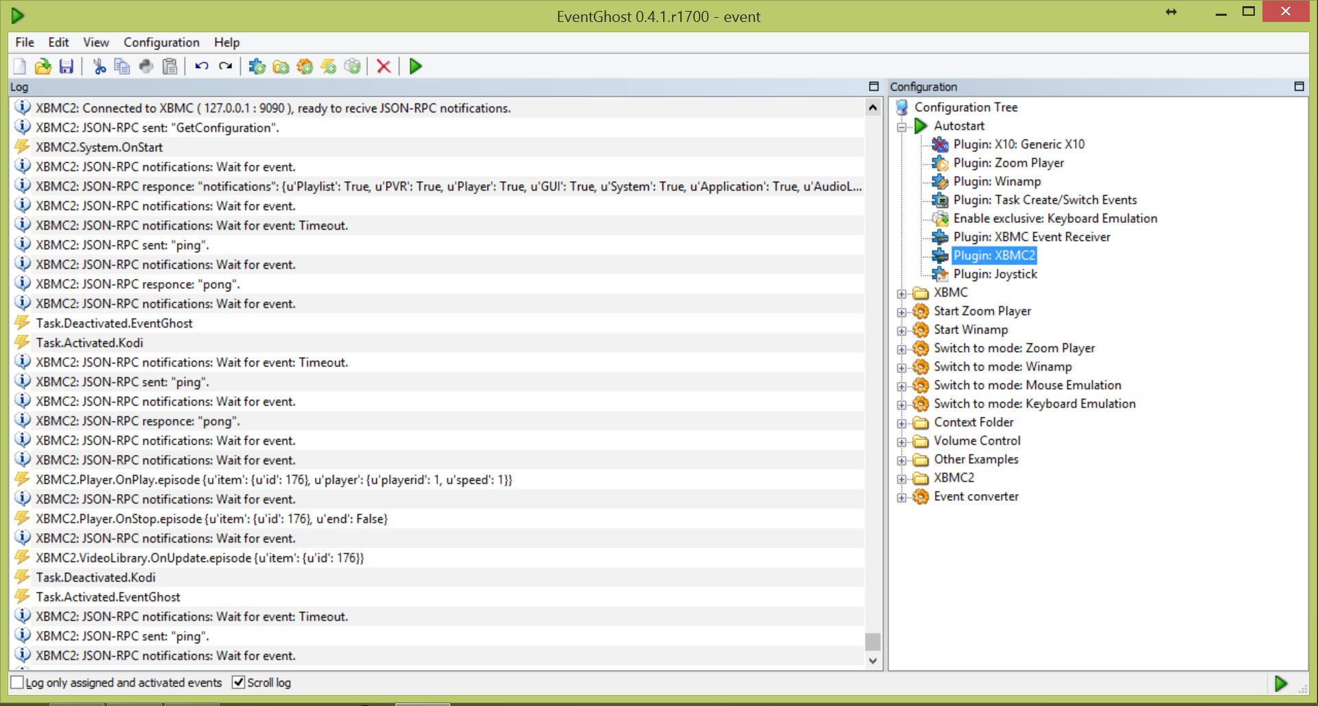

jonib wrote:Could you try the attached XBMC2 plugin? (Just place it in "EventGhost dir\Plugins\XBMCRepeat") activate the "Debug" option in the plugins settings, then post the EventGhost log after you have started Kodi and waited a couple of minutes. So I see what's happening after the plugin connects to Kodi.
I tried the plugin you gave me and I was just getting a timeout loop until I changed my HTTP port to '8080' in Kodi, then I started to get the 'Pong' response. I'm still not getting any events logged even after successfully getting the response though...
Acejoker wrote:I tried the plugin you gave me and I was just getting a timeout loop until I changed my HTTP port to '8080' in Kodi, then I started to get the 'Pong' response. I'm still not getting any events logged even after successfully getting the response though...
Your log shows that you are getting some events from Kodi, the "XBMC2.Input.OnInput*" ones. So it seems the plugin is working and properly connected to Kodi.
If you are missing some events then it seems Kodi is not sending them.
Edit: Try the attached plugin, It shows "Notifications" that show what events Kodi is sending, maybe yours is configured differently for some reason. So post this "XBMC2: JSON-RPC responce: "notifications":" from the log, thanks.

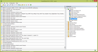

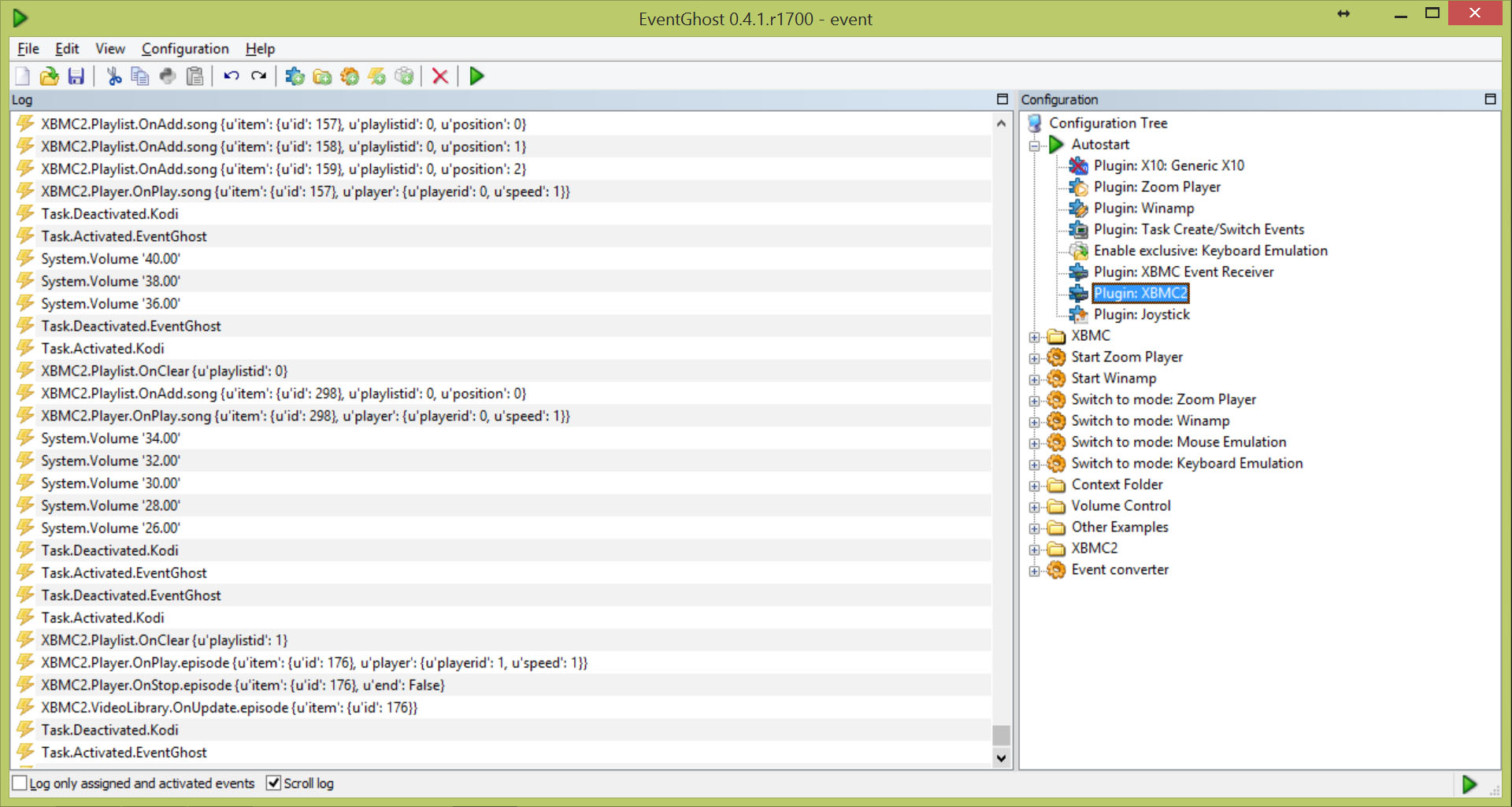

jonib wrote:Try the attached plugin, It shows "Notifications" that show what events Kodi is sending, maybe yours is configured differently for some reason. So post this "XBMC2: JSON-RPC responce: "notifications":" from the log, thanks.

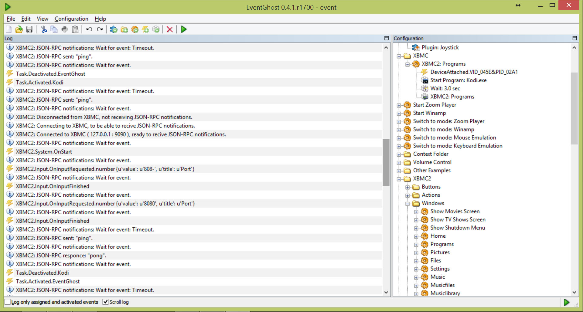

I downloaded your plugin and suddenly started to get notifications. However, I only get notifications for playback stop play event types. If I try to launch an addon, nothing shows up on the EG log. Here's a screenshot of xbmc2 displaying notifications from kodi in EG;
Here's the log from the plugin running the debug script;

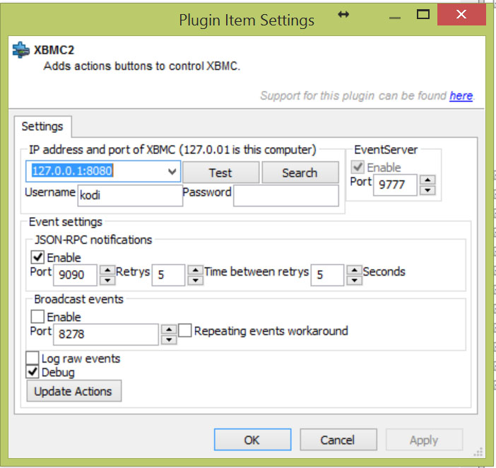

and finally, here are my plugin settings; in case I did anything stupid...
I wish I new if the plugin wasn't working because of some settings on my end, but I have no idea what I did other than install your new plugin to get XBMC2 to start login some events.
Acejoker wrote:However, I only get notifications for playback stop play event types. If I try to launch an addon, nothing shows up on the EG log.
It seems starting a plugin won't create an event at the moment, unless the plugin creates it itself.
Seems like EventGhost and my plugin works correctly for you now, so your configuration seems correct.
If you need some events that you are not getting you need to ask/make a request in the Kodi JSON-RPC forum, as I have no control of making new events.

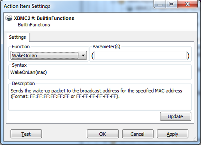

I also had no idea where to put the JSON Custom Code, so for anyone wondering this is where the code gets entered;
Add Action --> XBMC2 --> Experimental --> JSONRCP
Thanks Jonib

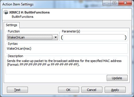

So the RunScript command is not available in the plugin at the moment. But I held this reply hostage just to force me to add this (and other BuiltInFunctions), it took a bit longer than I wanted. So sorry for the late reply and the next post will have a new development version of the plugin with the new functions.
Hi, so here is a new development version 0.6.23.
I have (finally) added all the missing built-In Functions, that I basically forgot to finish as I started to work on JSON-RPC support and my development became less efficient. :lol: :cry:
So there is a new action XBMC2->Experimental->BuiltInFunctions
It gets the syntax from Kodis wiki unfortunately not all functions parameters are documented.
Edit: I did a fast update to add support for using Python code in the parameter field using "{ python code }",
Like always please backup your config and old plugin if you are going to test/use this. Any feedback is appreciated.
XBMC2 dev ver 0.6.23 The function(al) edition.
