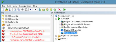

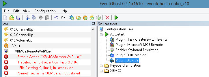

backbone10
Joined: Fri Mar 15, 2013 9:28 pm
Post by backbone10 »
i would be very happy if someon can help me, since i am not an expert :(
I use XBMC 12 on W7 64, a x.10 remote and eventghoste and of course the xbmc2 plugin.
it was hard to find out how to get it configured for me, but o got it working, at least for a few weeks..
Altough i really did not change everything it looks like it is missing some infos
and i get the message :
Error in Action: "XBMC2.RemoteVolPlus()"
Traceback (most recent call last) (1610):
File "<string>", line 1, in <module>
NameError: name 'XBMC2' is not defined
its only an example for the vol+ key, no key that i defined in the past is working now..
i also tried to make a fresh installation, but without a change...
If further infos are required please let me know.....
thx for your help
br
bb10
backbone10 wrote:If further infos are required please let me know.....
Attach your EventGhost config file, and I'll look into it.

backbone10 wrote:Altough i really did not change everything it looks like it is missing some infos
Well something has changed, EventGhost has replaced the actions for the XBMC2 plugin with PythonCommand actions for some reason so they don't work.
I have seen this happen when the correct plugin was missing when starting EventGhost and then saving the config.
I have attached your config that I have tried to fix, if it don't work and you don't have a (older) backup of your EventGhost config, you will need to re add all the actions you want to use.
eventghost config_x10 - Fixed.xml
(70.17 KiB) Downloaded 145 times
backbone10
Hi jonib,
that did it , you are the hero of the day for me :)
i will backup my configs from now...
thank you very much for your help !!!
